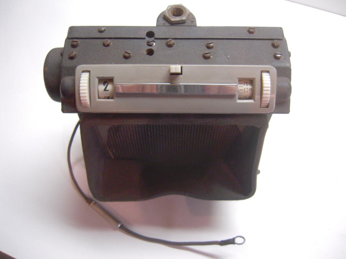

The antenna "plugs" directly into the radio body. Note in the attached photo the "nut" at the top-center of the radio? That's where the antenna is fitted.
The radio is installed prior to the antenna so yes, the antenna can be removed or installed without removing the radio.
While you did not mention whether you are working on a closed car or a convertible, the antennas, while configured differently respective of model, fit to the radio the same way.

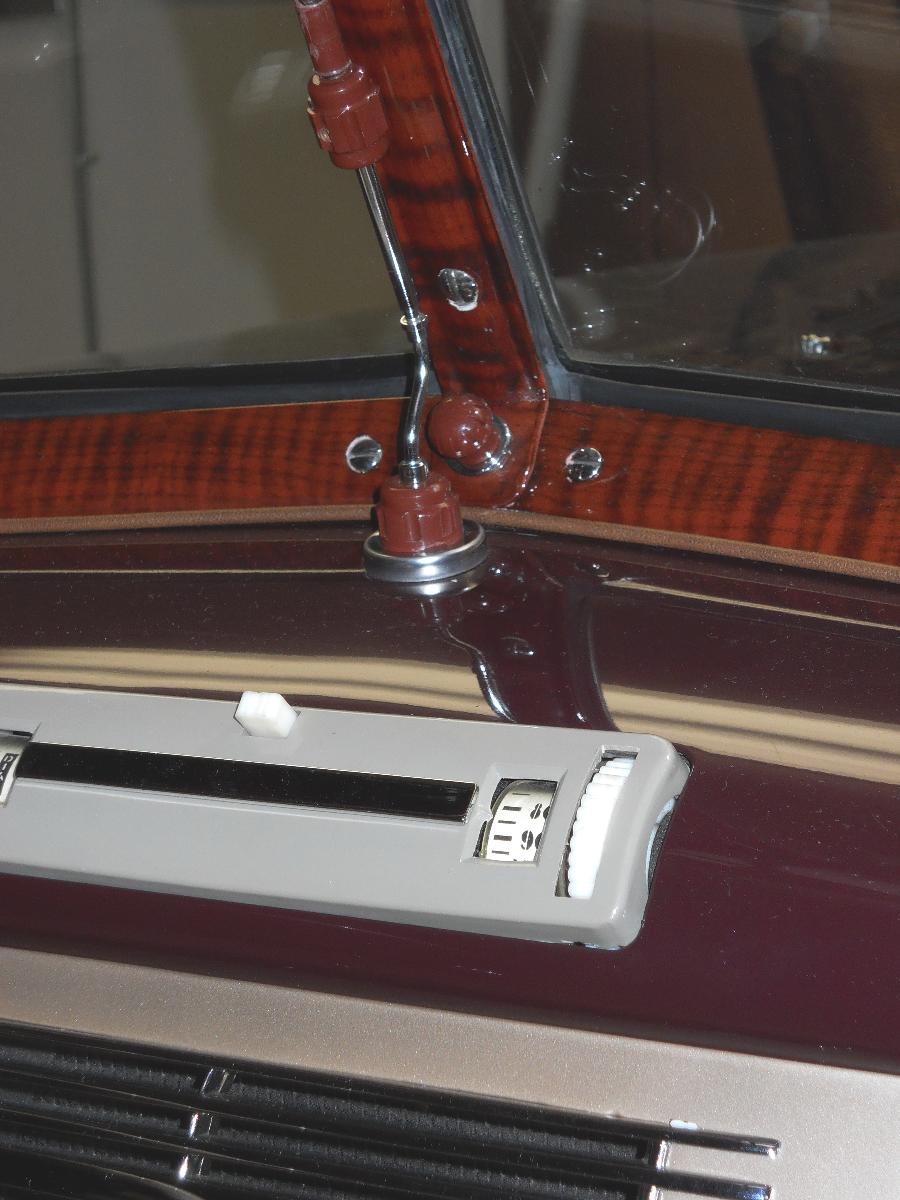

Yes. There is a special adapter "nut" that threads into the radio. Carpenter sells them. He also sells the antenna kits.

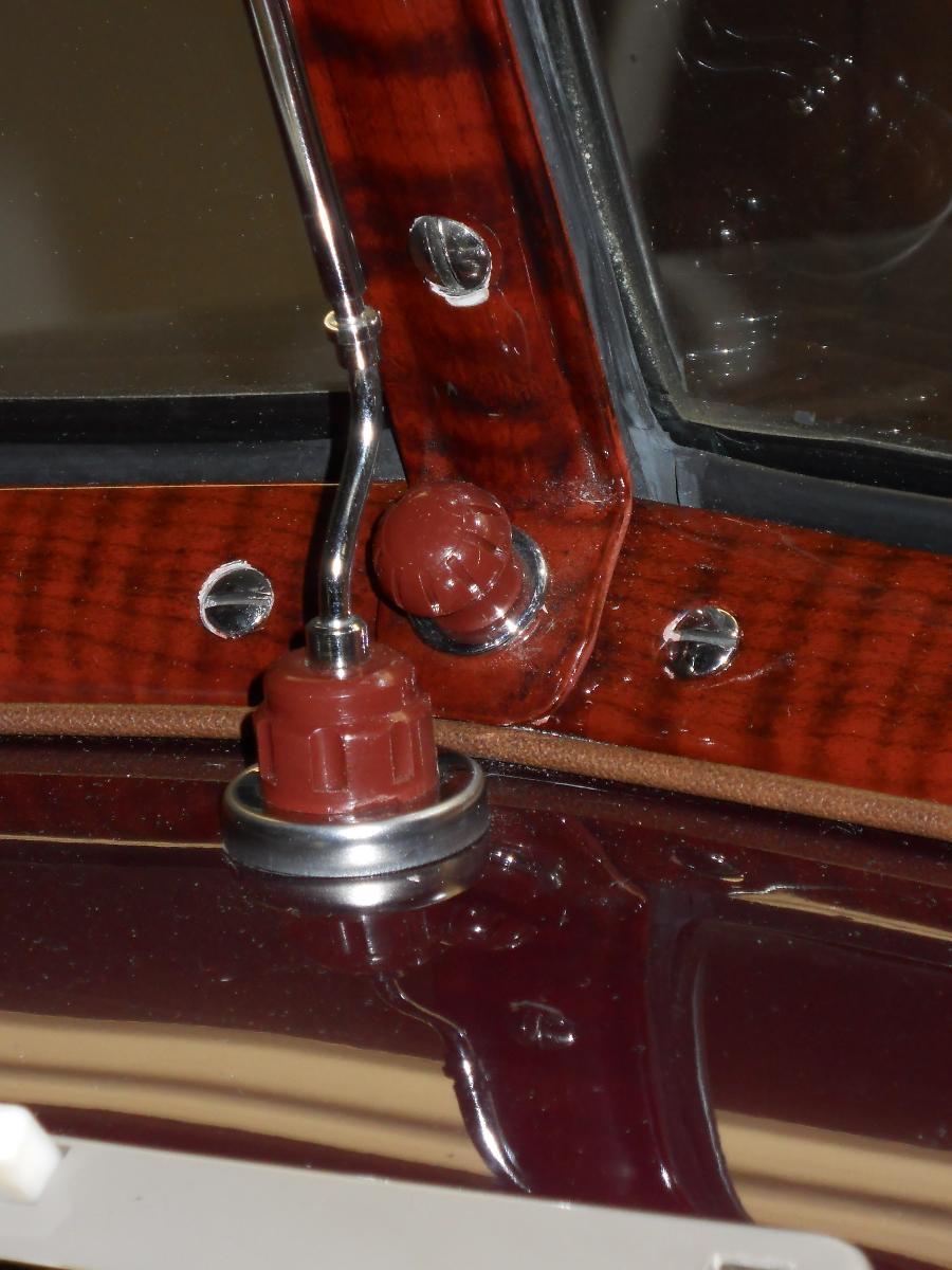

Photos attached showing the antenna nut installation that he is talking about.
Hope these help you.

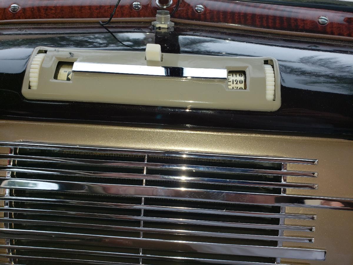

Photo of the special, insulated adapter nut holding the radio in place from the top (note the rubber insulator visible at the top). The lower end/tip of the antenna goes into the center of the insulator to a metal contact inside-I can't remember if the contact that the tip of the antenna touches is inside the nut or if the insulator is a hollow pass through.
The nut supports the entire weight of the radio and grounds the radio case to the top of the dashboard (the two "J" shaped hooks with wing nuts at the bottom front of the radio hold it against the front of the instrument panel).
