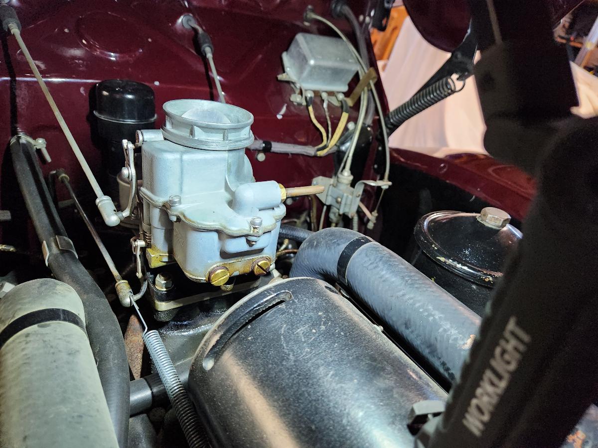

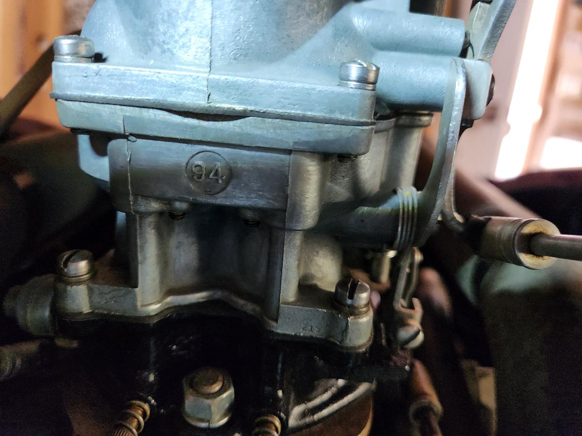

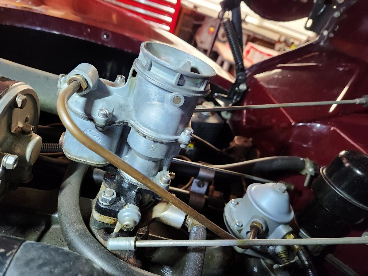

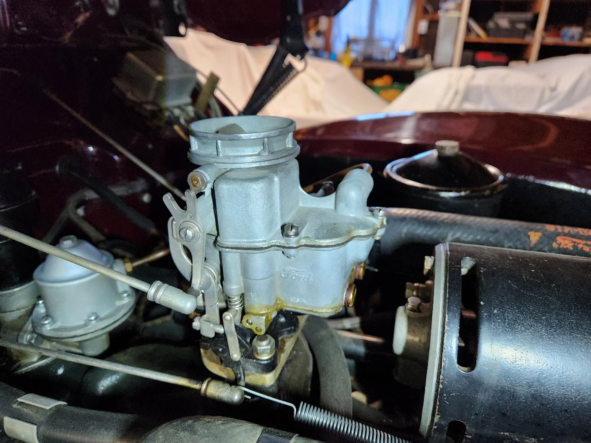

Appears I have leaking gas from the carb. Instead of rebuilding, has anyone used a more potent off the shelf carb? TIA
03-08-2023 @ 3:13 PM
Posts: 1975
The Ford/Holley carburetor is a great one. It has a center hung float which is great for maintaining proper fuel delivery while executing extreme vehicle cornering maneuvers and it was originally calibrated to perform properly on your engine. My recommendation would be to rebuild it or replace it with a new Holley 94 carburetor available from several of the parts vendors.
