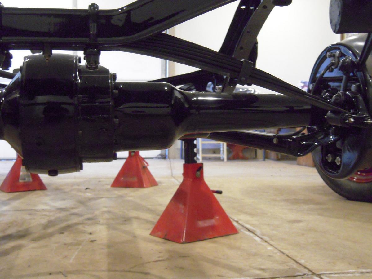

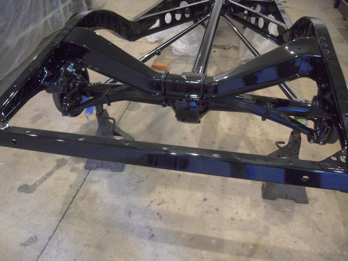

Dale, I've attached two photographs of a Columbia installed to a '40 chassis I am working on.
They do make a rather impressive difference in the drivability of an old flathead Ford.
Necessary? Not really. Nice? You Betcha!
The Columbia was not offered by Ford for Ford vehicles in 1940. Rather, it was an after-market item. If memory serves, it serves about a 28% reduction in gearing (ratio) reduction.

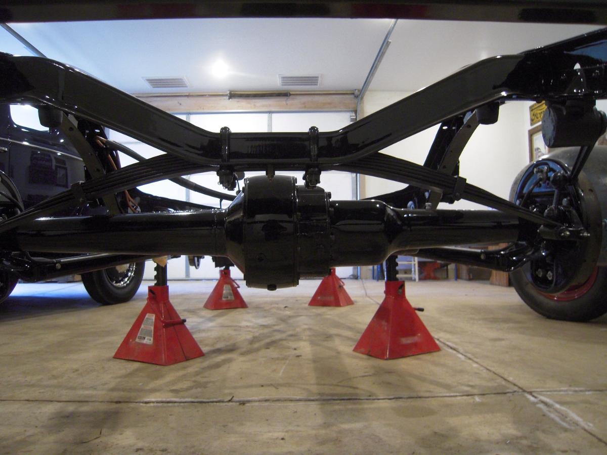

Dale, For comparison, here's a photo of a stock differential installed to another '40 I'm working on.

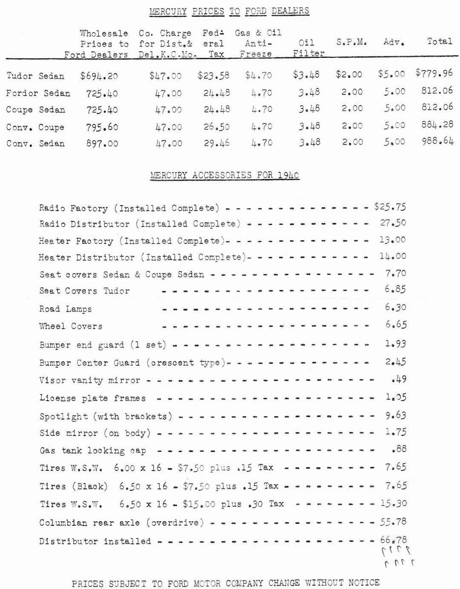

01-24-2023 @ 7:03 AM
The Columbia was a factory installed accessory on the 1940 Mercury. It cost the dealer $55.78 factory installed and 66.78 if installed at the distributor.
A similar listing for the Ford was not with the price lists that I have.

01-25-2023 @ 5:02 AM
That sheet has no date. It was with the price list for 10/6/1939 from Kansas City Branch. It is the only sheet like this that I have seen. There was no corresponding list of accessory prices for the Ford or Lincoln Zephyr in the folder that I bought.
In 1978, I bought a file folder of 1940 literature from a guy in Peoria who was restoring a 1940 Mercury convertible. He said that he acquired it with a bunch of parts and catalogs he bought from a dealer in MO that was cleaning house.
