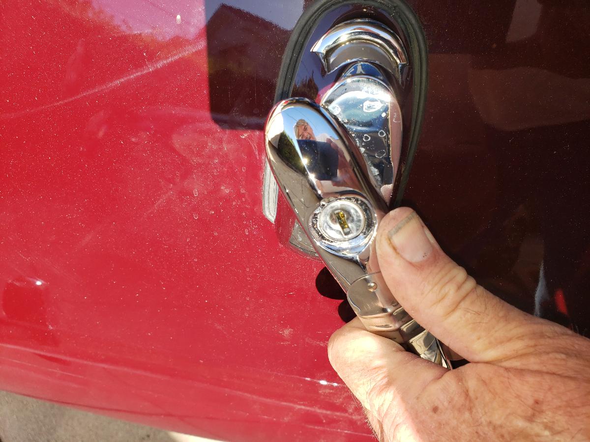

Looking at it this morning, it doesn't look like the trunk handle is turning far enough. This is full deflection... I did try pushing down and turning, but that didn't work so far.
kubes40 |
10-28-2022 @ 4:45 PM
Posts: 3574
With that little amount of "twist", it appears the trunk is locked.
