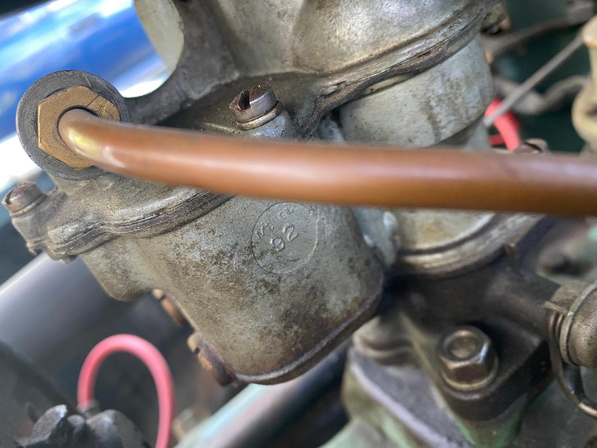

I think I just discovered my car has the wrong carb on it. It has a ford script “92”. That is stock on a 40 v8-60 if I am correct. My car being an 85 hp it should have a 94??

The Carb appears as a 94 which is the style but it is the incorrect model which should be 91-99 for the 1940 85HP car. The correct model should be marked 91-99 and the top does not have the large round vent tube in the center of the venturi, the vent should be an oval hole in the casting. The model 92 is for the 60HP and installed on a 85HP engine should restrict performance due to many difference in the Carb.

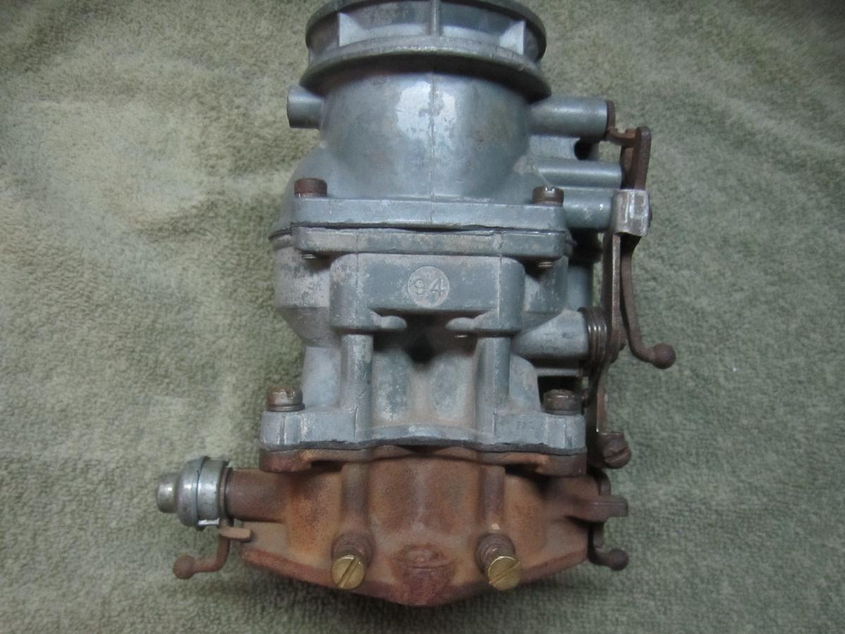

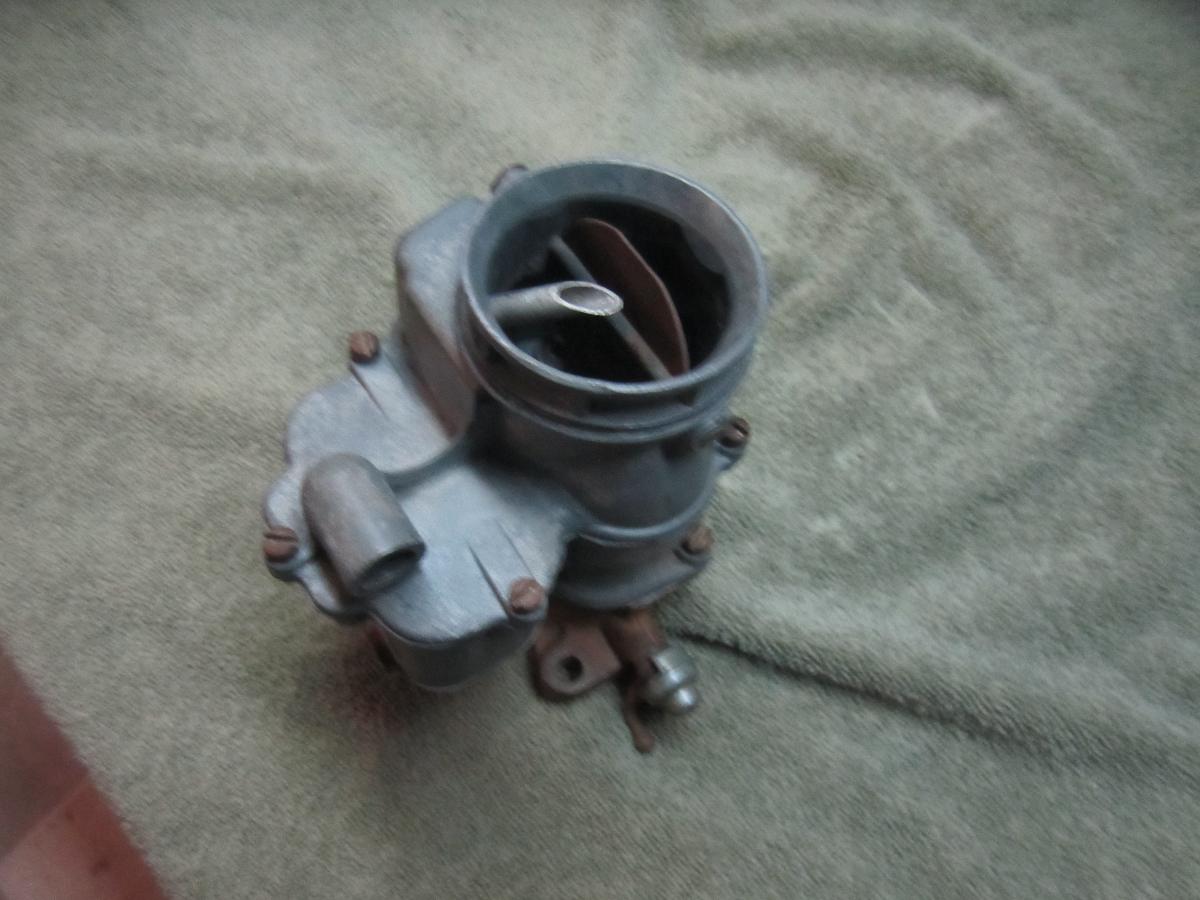

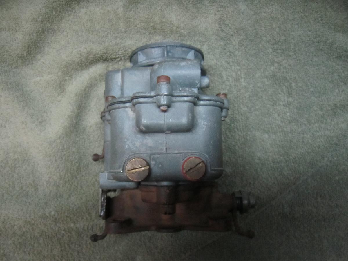

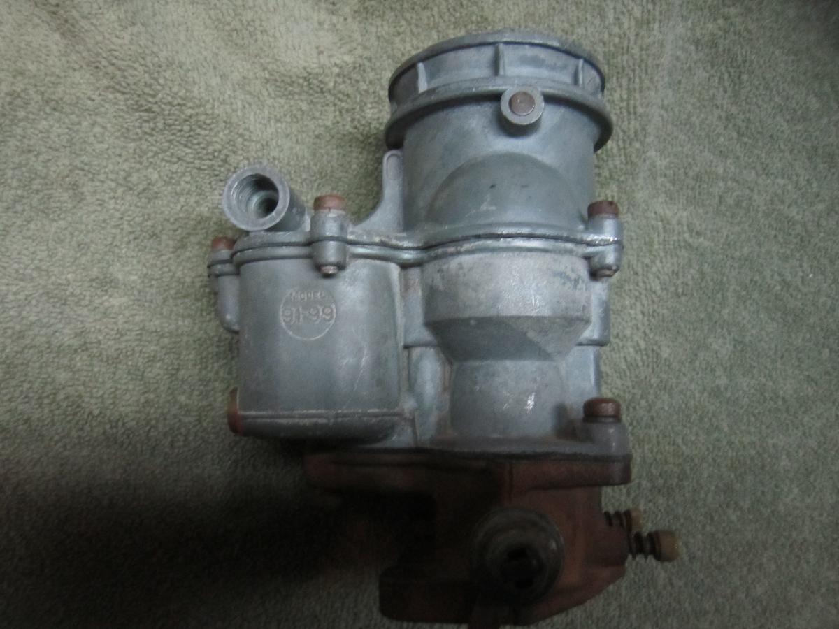

Here's photos of the correct carburetor for your '40.

Try Charley Schwendler in NY. He may have a good rebuilt available. cas5845@yahoo.com The line from the fuel pump to the carburetor looks like it may be copper. Check it with a magnet. If it is copper, you should replace it with a steel line. Third Gen shows that they have the line and the drawing shows it bent for installation. https://thirdgenauto.com/page/6/?s=fuel+line&post_type=product&type_aws=true
