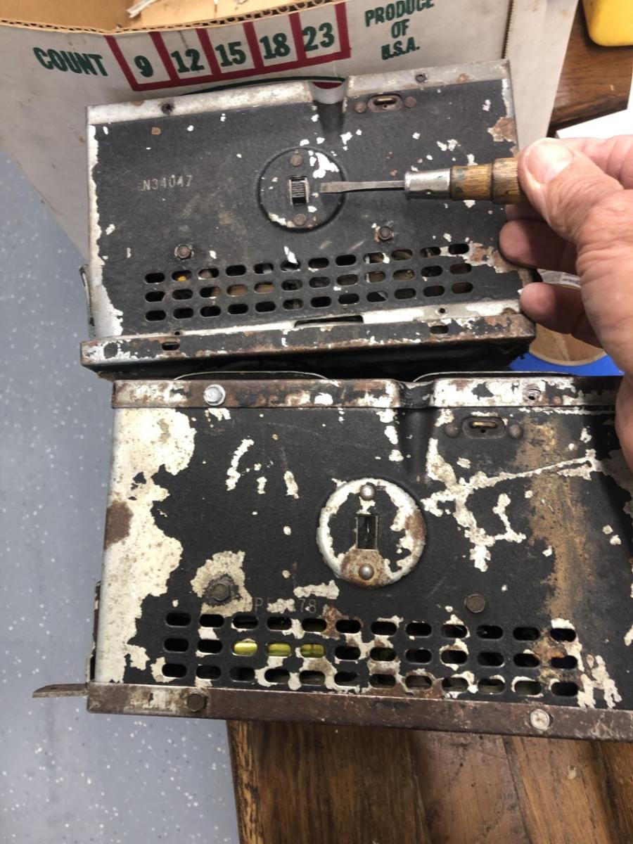

What is the switch on the bottom of the radio for? I have a fully intact radio that appears to have the switch knob broken off and I have a "parts" radio that has the switch intact. ALSO, who has had good luck with the radio conversion to FM or "bluetooth" capability? Do you have a company to refer? Thanks.

I climbed under the dash of my 40. Confirmed that the switch you see is for "Tone Control". You can set it for "Bass" or "Bright". Assume that also means "Treble".
The Radio Owner's Manual has the following in it under the Tone Control section:
"It is to be observed that when the tone control is in the bass position the noisy interference from street car lines or other sources of electrical disturbance is considerably reduced".

I was wondering about that switch! Another question- how do I tell if the radio is a philco or a Zenith?

As I recall, the Zenith has a channel in the back for the Cowl Vent lever to clear, the Philco does not.

You are correct, sir.
Mike's book, on pages 5-22 and 5-23 - talks about radios. Lots of good info.
The picture on page 5-23 CLEARLY shows the difference between the Philco and Zenith brand radios.
