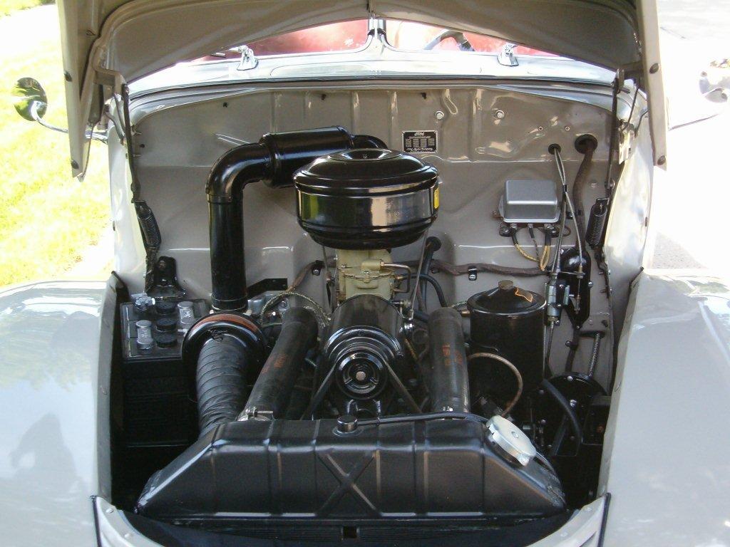

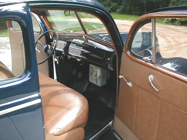

09-09-2021 @ 4:47 PM
Posts: 3573
Dale, The owner manual does not call out any "options".
There was both a hot water heater as well as a hot air heater in 1940.
I have attached two photos that will in part depict each type.
