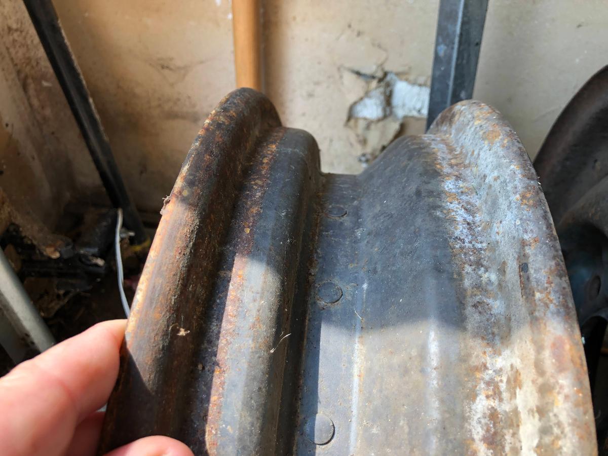

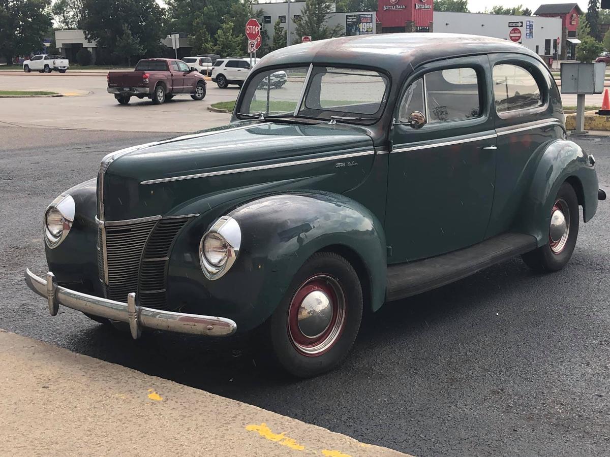

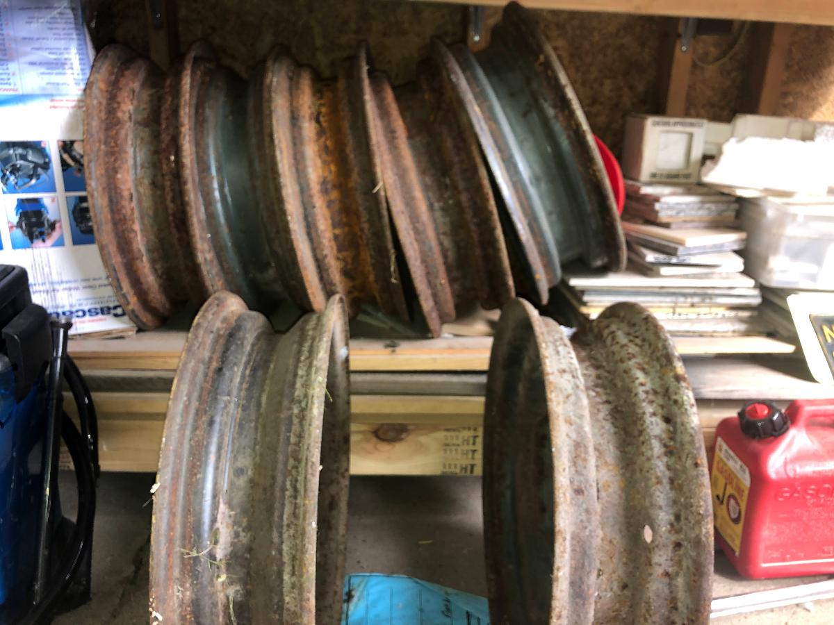

Looking for a little help. My 40 Ford Deluxe Tudor has 15" wheels on it. I have 7 original 16x4 wheels, but they're in need of some work. I plan to sandblast them, then paint them the correct original color. Anyone have a source for the paint? Car is Cloud Mist Grey, so the wheels should be as well correct? Beyond that, is there a market for the 15" wheels that are on it? They'd include the 4 trim rings but not the center caps Thanks, Dave

The wheel color on your '40 deluxe were painted to match the body color. I'd suggest you bring the cowl vent lid to a good automotive paint supplier in your area and have them match it. The (7) wheels you have... prior to spending any money on them, are you certain they are 1940 rims? Fifteen inch rims have some value... Mike "Kube" Kubarth

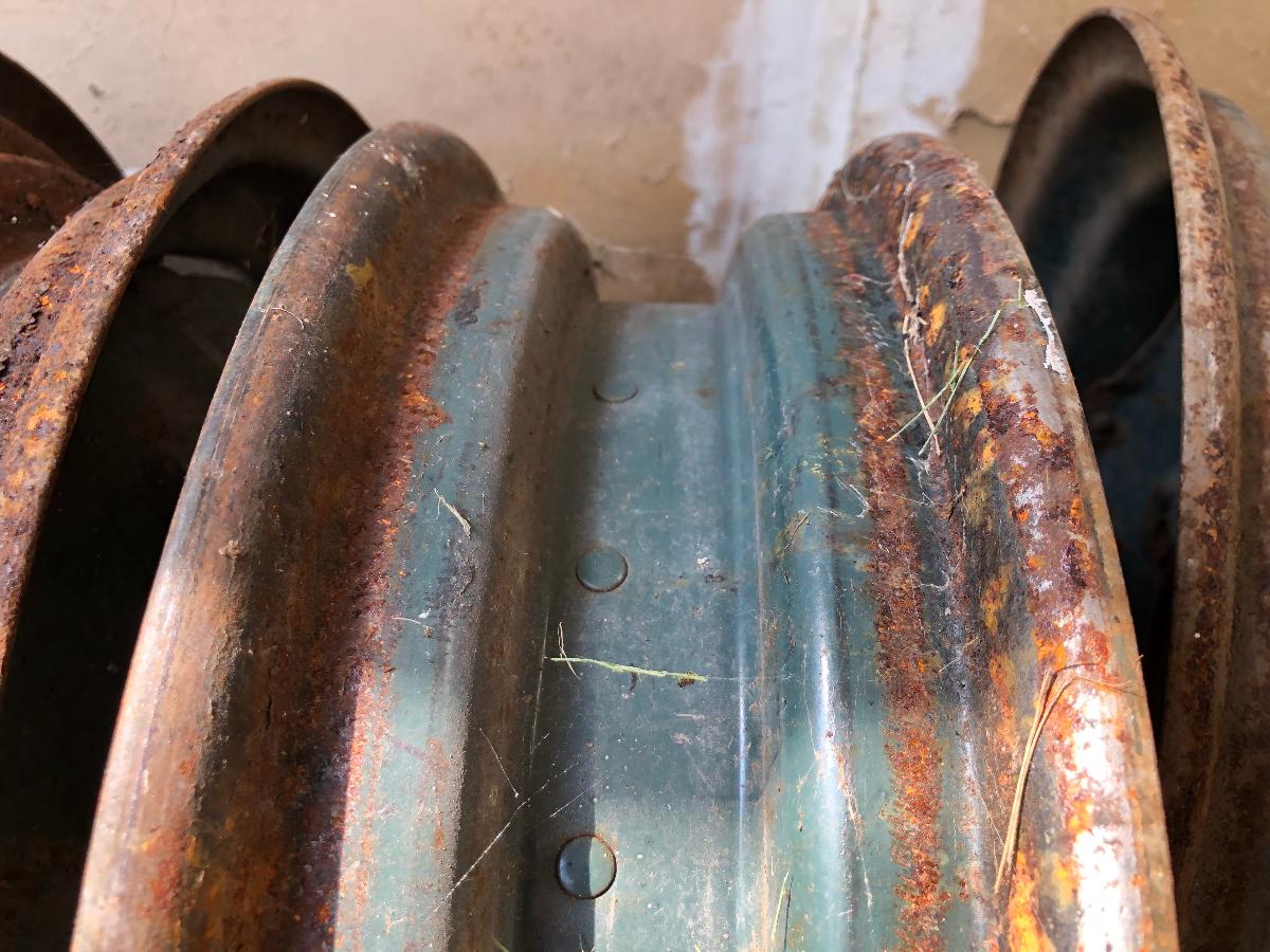

Mike, Is there a way to be sure they are 40 wheels?

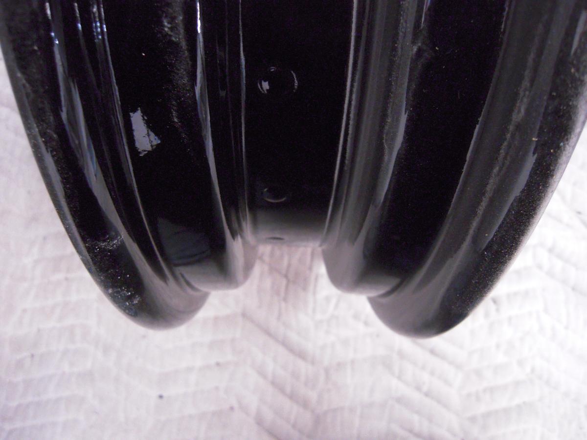

DM, Yes, easy... check the profile. A correct '40 rim has what I would call "near right angles" vs. the later rim where the center slopes to the outside. It looks like you have a nice car there. And, I was only guessing you'd rather "do it right" as long as your doing it. The photo in your post to the far left is a later rim. The photo in the center is correct. Mike "Kube" Kubarth
