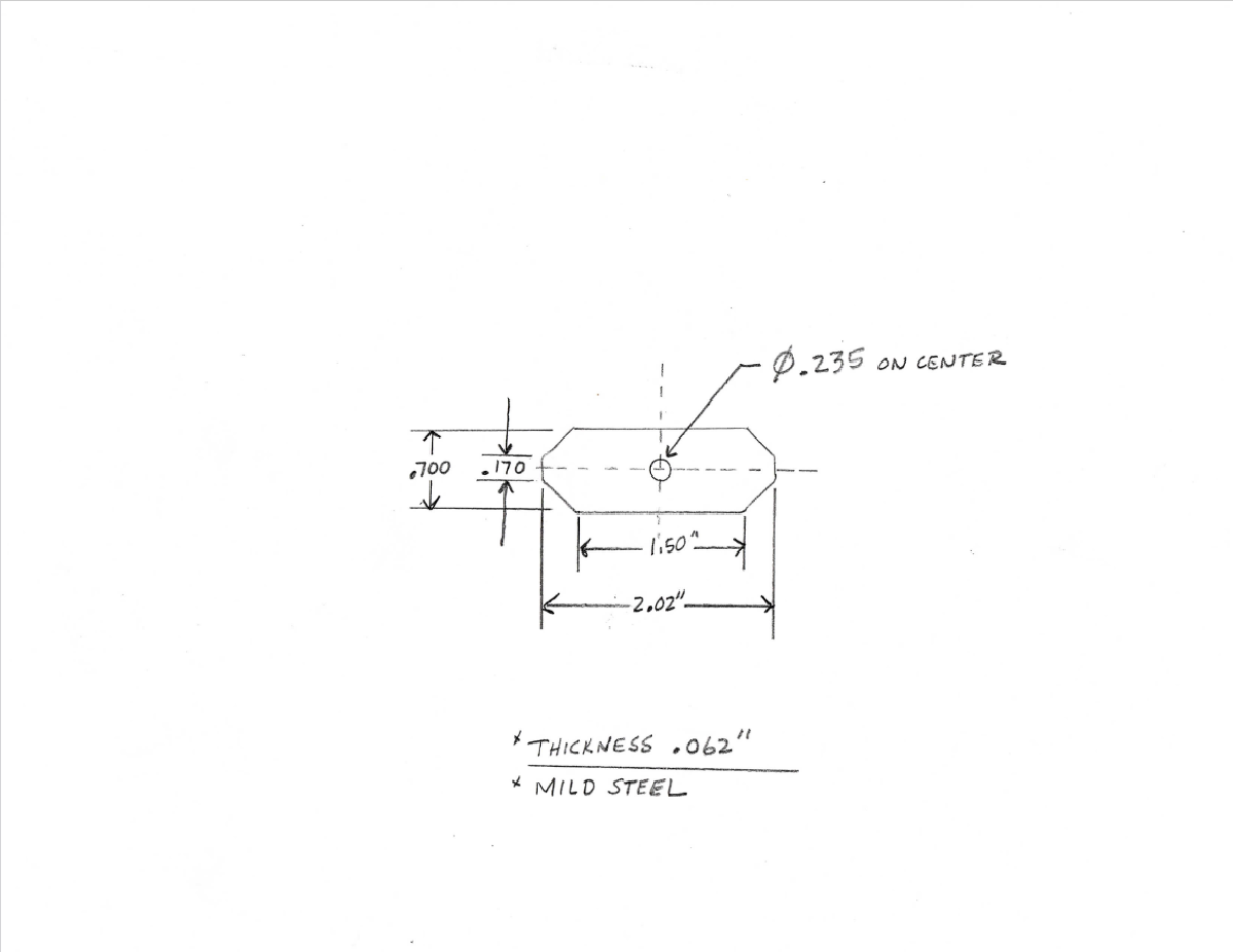

No, they have not. However, they are easy to make with "basic" tools.

I will see if I can make them out of sheet metal.

I think sheet metal will bend when you tighten it down. I think you will need to use something heavier than sheet metal.

Let me see if I can draw a sketch up for you. I should have a plate around here Give me a day...

Here ya go:
