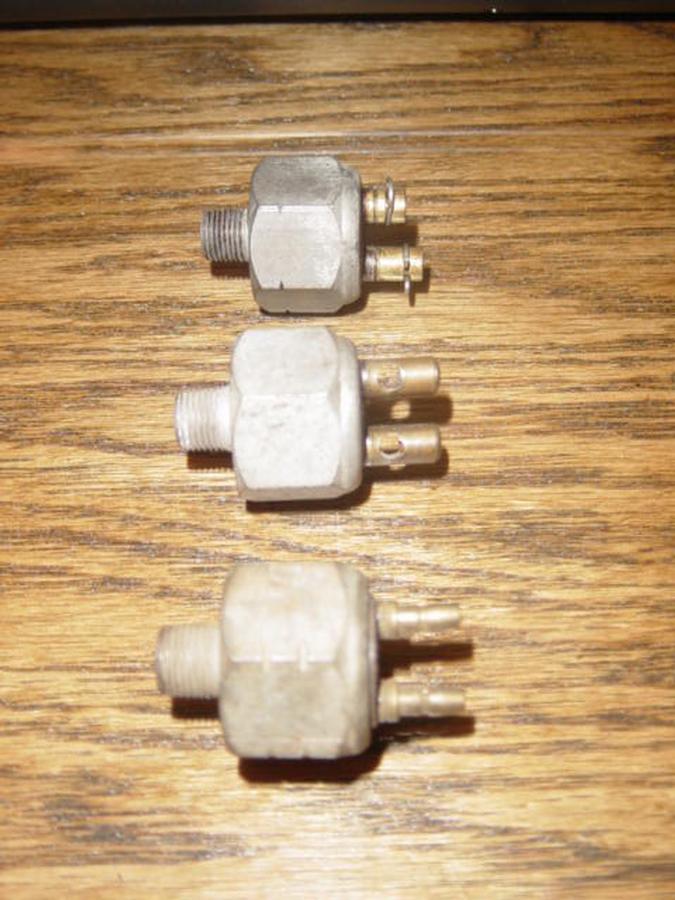

beside the hydraulic connection there are many different electrical connections.
