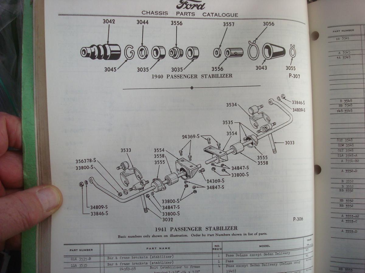

What I see in the FORD PARTS list, is a for a 1941 FORD,pass stabilizer 11A 3535
it seems to me that the stabilizer is the same for 1940 FORD and 1941 only the bushing is different in 1940,?
I ENCLOSED a photo ,
seems like this was only for 2 years, 40-41
from 1942 to 1948 FORD used a TRACK BAR, 21A 3550
I see also that SPEEDWAY has a track bar to fit many early Fords with I beam axle
my 2 cents, 1937RAGTOPMAN

if you look at the photo of the difference between 40 and 41
it shows the difference in the bushing's from one year to the other
not the same part numbers,
my 2 cents 37 RAGTOPMAN

I wasn't aware of any photos in any Ford parts books. Illustrations (quite generic) which help find the proper piece sure...
