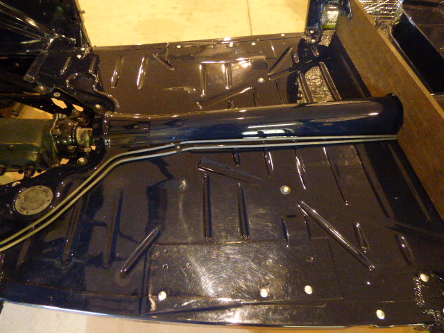

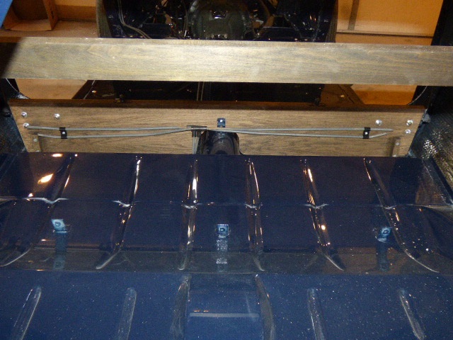

I have attached a photo.
08-30-2018 @ 6:08 PM
Posts: 3574
Here's a "live" photo that should give you an idea of how the lines were authentically run.
08-30-2018 @ 6:09 PM
Posts: 3574
Here's one more....

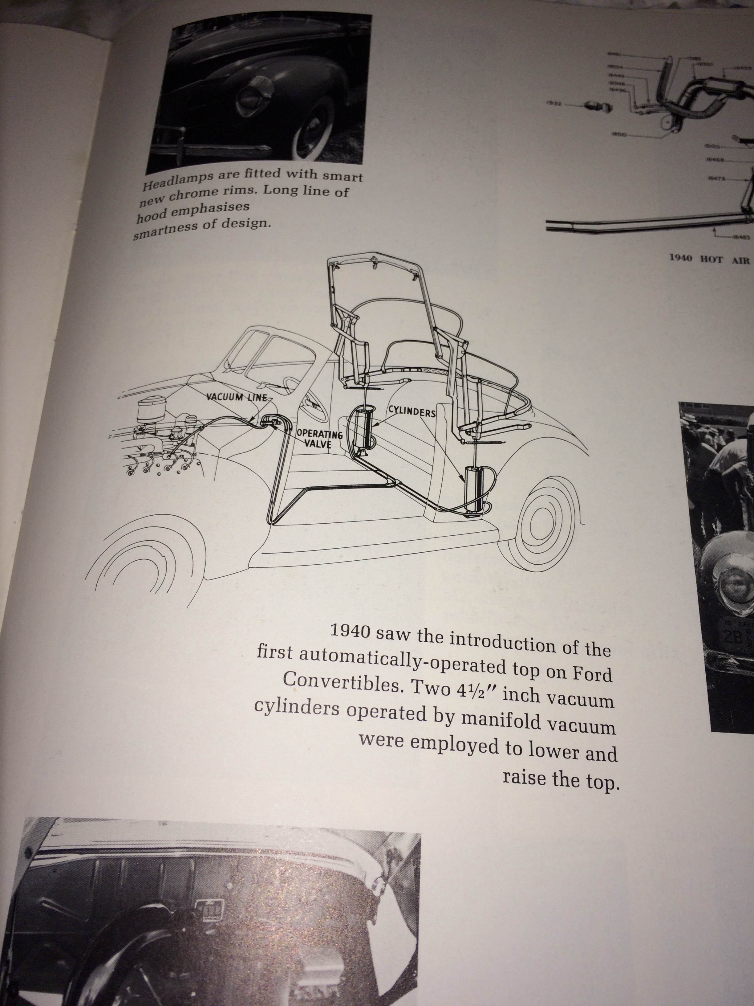

I don't have the 1940 body book. Can anyone send a diagram to show the lines origins and destinations??
Regards, Steve Lee
08-31-2018 @ 6:10 PM
Posts: 3574
Three posts "up" ...
