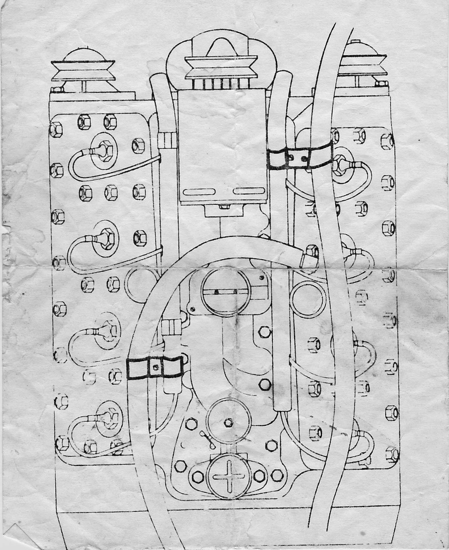

Does this happen every time that you drive the car? Is your heater connected according to the attached diagram?
If it is not, can you post a photo? Do you have dual temperature sending units?
In this diagram the heater hose input is on the right head and the temperature sensor is on the left head. I cannot see how turning on the heater would affect the thermostat on the left head enough to make the gauge go to hot.

Everything is set up like the diagram.I have one temp. sending unit and it is on the left side.I did close off on the water valve some.I drove car today and had no problem this time!It is weird,I can not remember having a problem last year when I went to winter set-up.It almost seems like I have a thermostat sticking?I also added about a quart of coolant.I guess I lost that filling up the heater routing?
