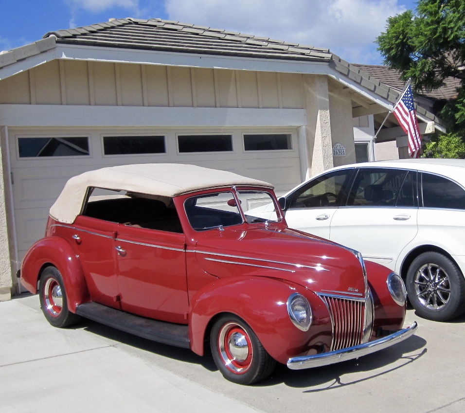

Mike, I'm in the process of changing a 39 convertible sedan INTO a 40 Deluxe. I'm a 40 guy always have been (my first was at 13 in 58) the one thing I can't find any info on is installing 40 convertible vent windows in the 39 doors and not ever having a 40 convertible (lots of coupes & sedans) I have been told the convertible door handle is different than the sedan - please enlighten me as to what the difference is. I have purchased new 40 convertible door latch components from Drake, yes I understand I will need to modify my existing 39 front windows to work with the 40 vents, plan on using 40 convertible lifting parts not 39, do you see any issues with this setup? Thanks Ted
