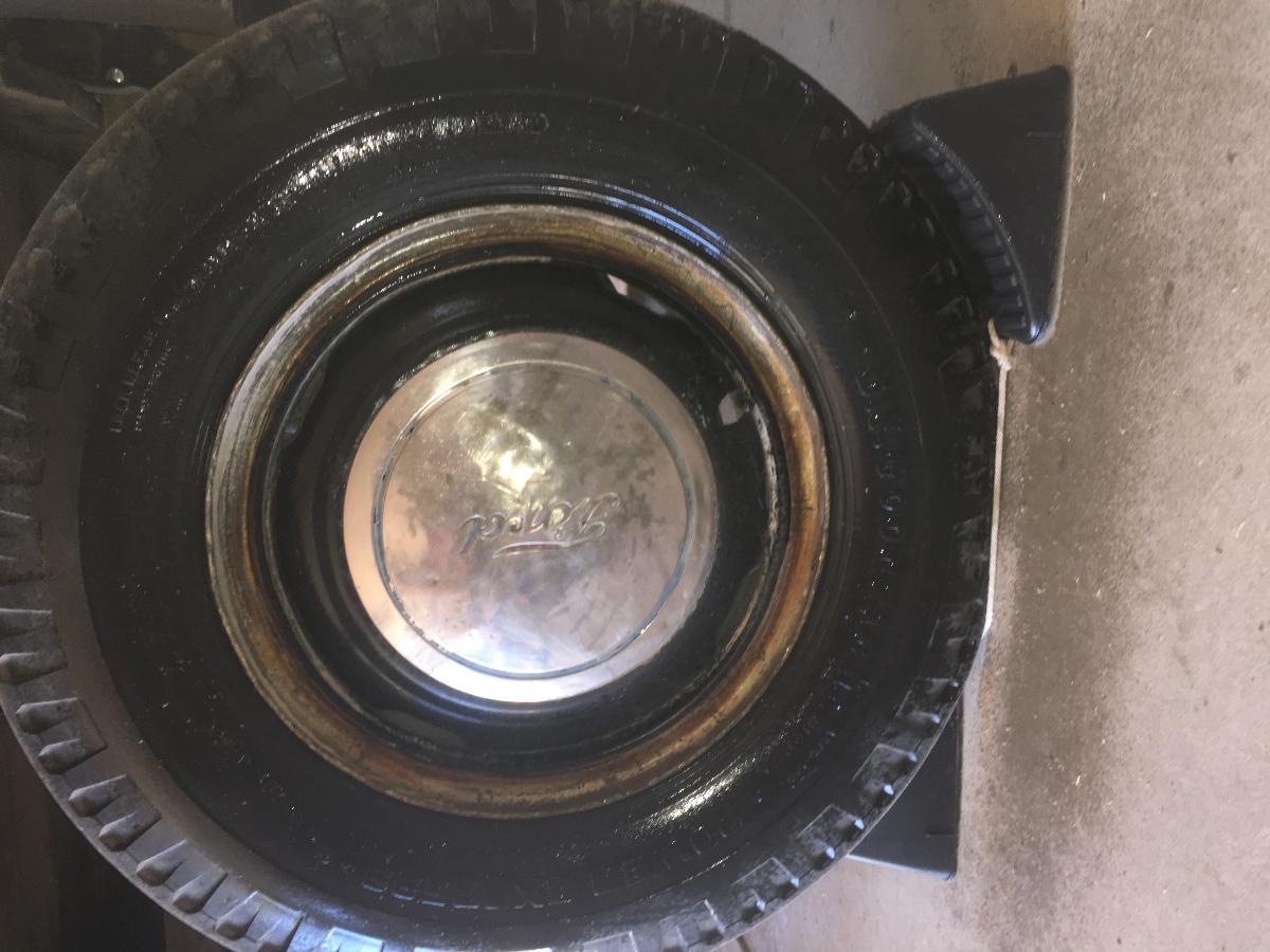

I need to know if this wheel is what is known as a widow maker.

I have a 47 Tonner with split rims, Truckdog (who knows his stuff) tells me they are not WidowMakers......

I should check in here too more often. The 1938 to 1947 Tonner wheels have what is called the Firestone RH type outer rims. This is not the widow maker RH-5° that has become a pariah within the service industry. But the RH does require handling by a service technician who knows them. Which is why most chain tire shops will be of no help.
Regrettably there are no bolt on replacement options. The tonner is the only road going vehicle I’ve found record of that used the 5 x 6 7/8” bolt pattern in a none military application. Even military wheels are too deeply dished to be of use. So I’d suggest finding an old independent shop, an agricultural shop, or a big truck shop. Stu
