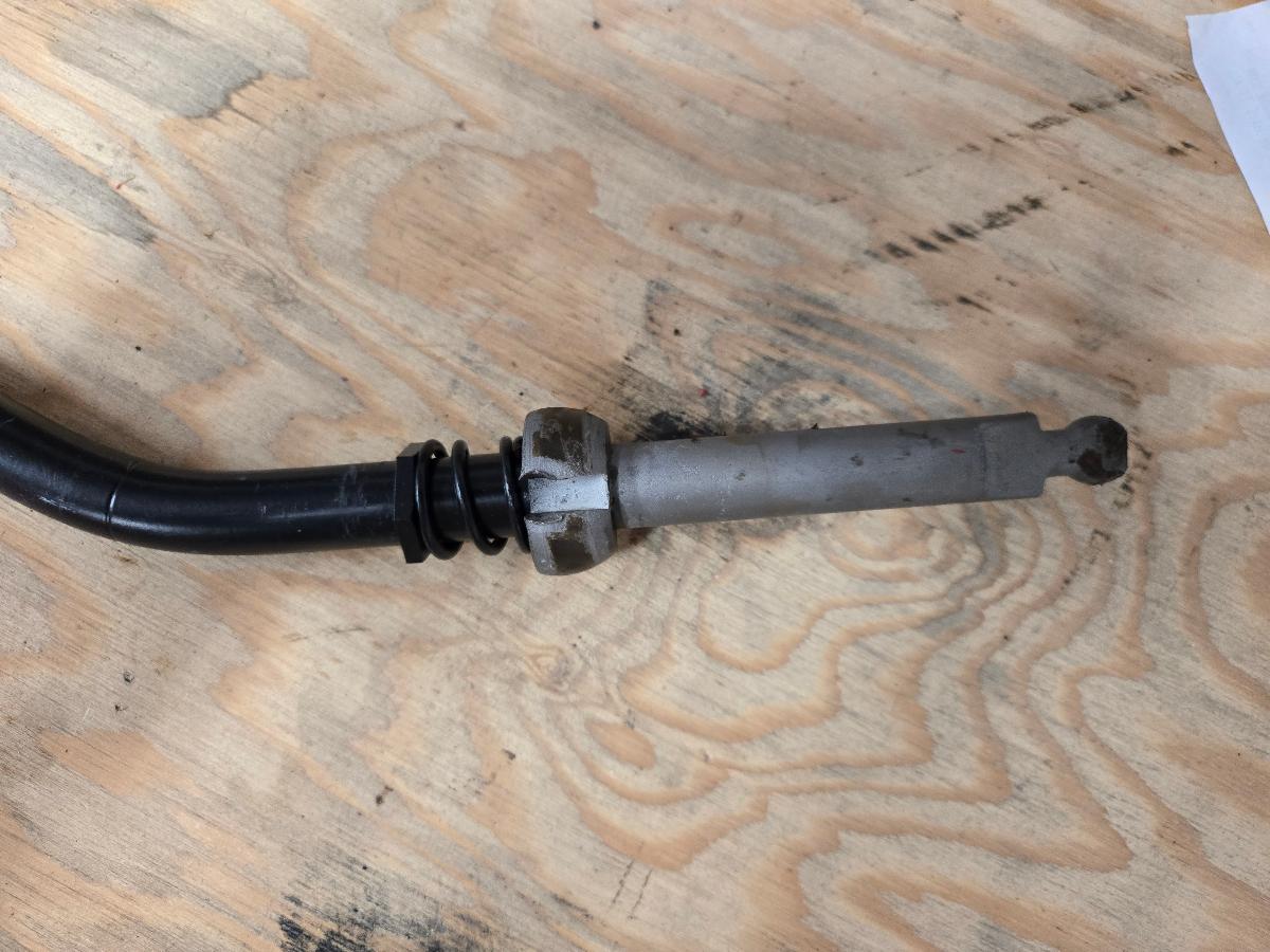

I am restoring a 47 Tonner 4speed. I think there is some kind of pin, etc that goes into the slot at the bottom of the 4speed tranny shifter, can anyone shed any light on how it works, where i can get the part, etc?

Contact VanPelt for help with this transmission. According to the "Green Bible", Ford Chassis Parts and Accessories Catalogue, this part is number B-7221 - Pin (Gear Shift Lever to Housing).

Thank you, I have talked to Mac VanPelt & i am all fixed up.....Gracias!
