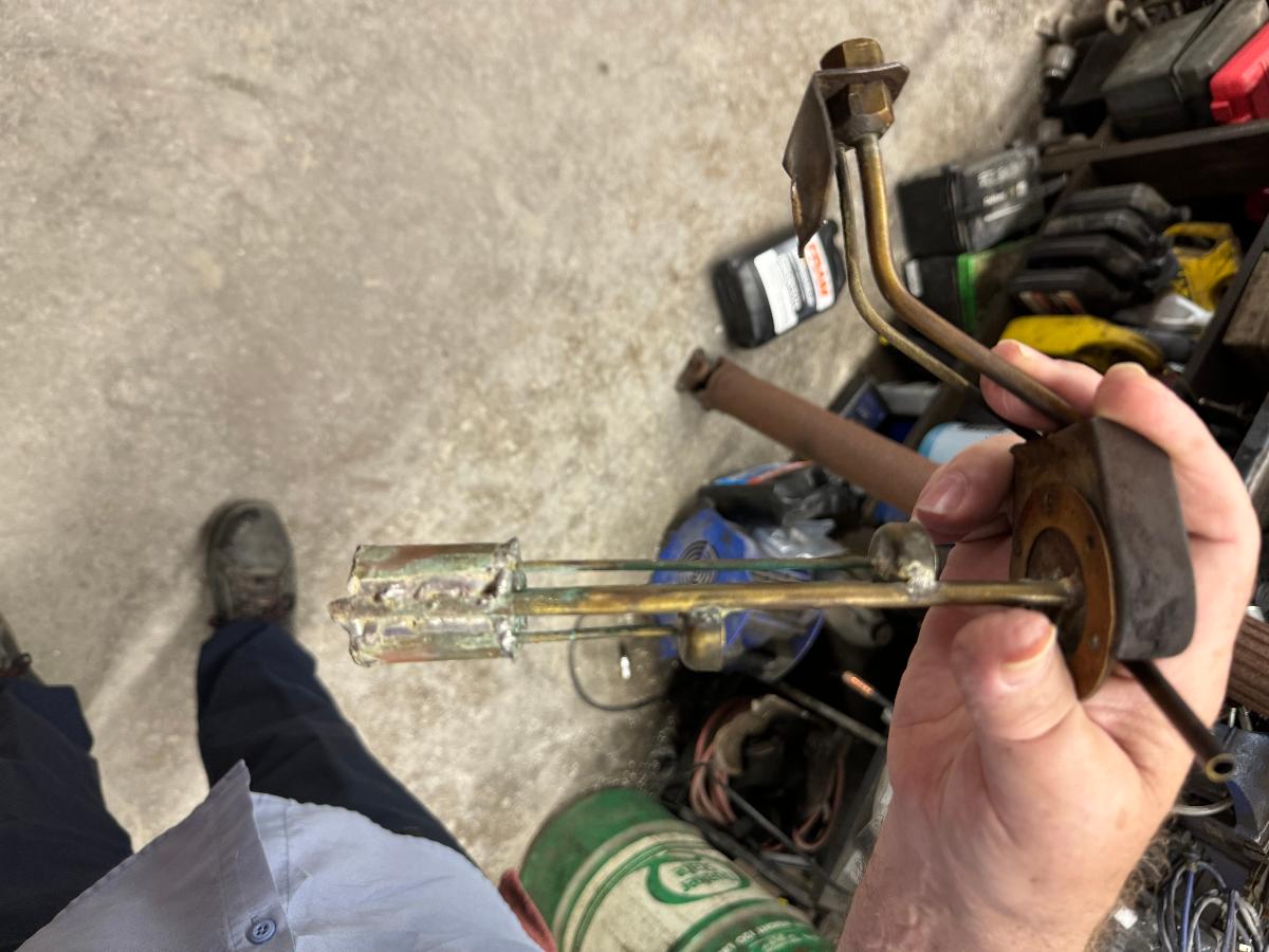

I’ve been having numerous fuel system issues on my model 18. See my other post on the fuel pump. I pulled the unit and learned that it had been modified and has numerous pinholes right above where someone attached a fuel screen. That may be contributing to a vacuum problem and sucks air unless the tank is half full. Where could I get aftermarket replacement that would still have the little fuel level cups that drive the gas gauge? Need it pretty quickly.

06-12-2024 @ 4:59 AM
Posts: 1799
