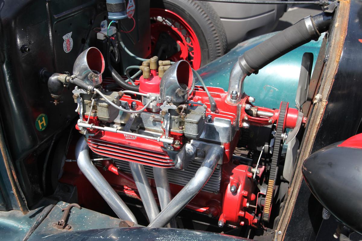

Thank you, very much, Charlie. The photo of the 4 cylinder you saw, is very interesting and, perhaps, even inspiring. Your suggestion to stay with the 4 is definitely inspiring. Being on the fence about the swap, I'm now inclined to go with your suggestion. Thank you, much.
