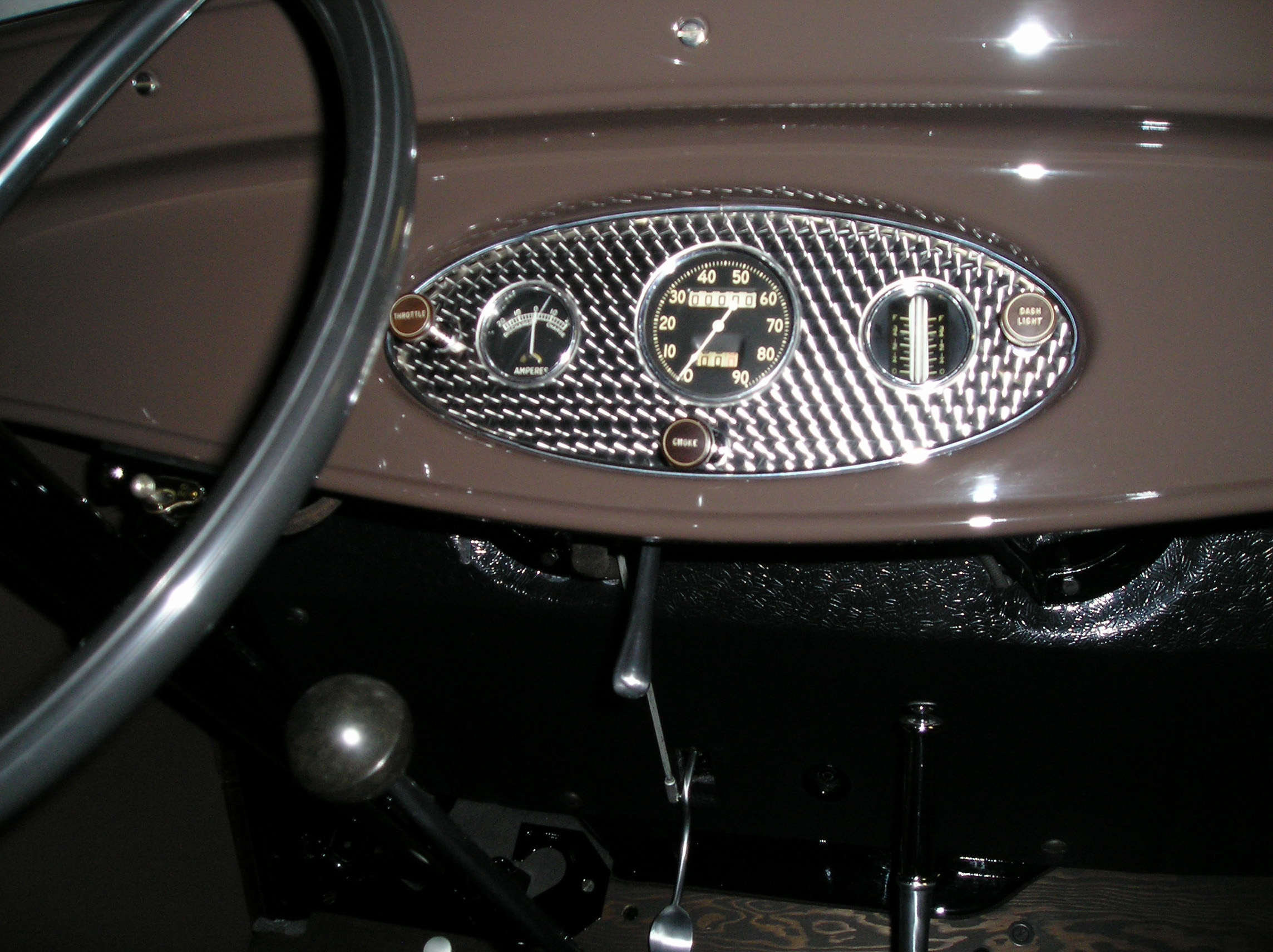

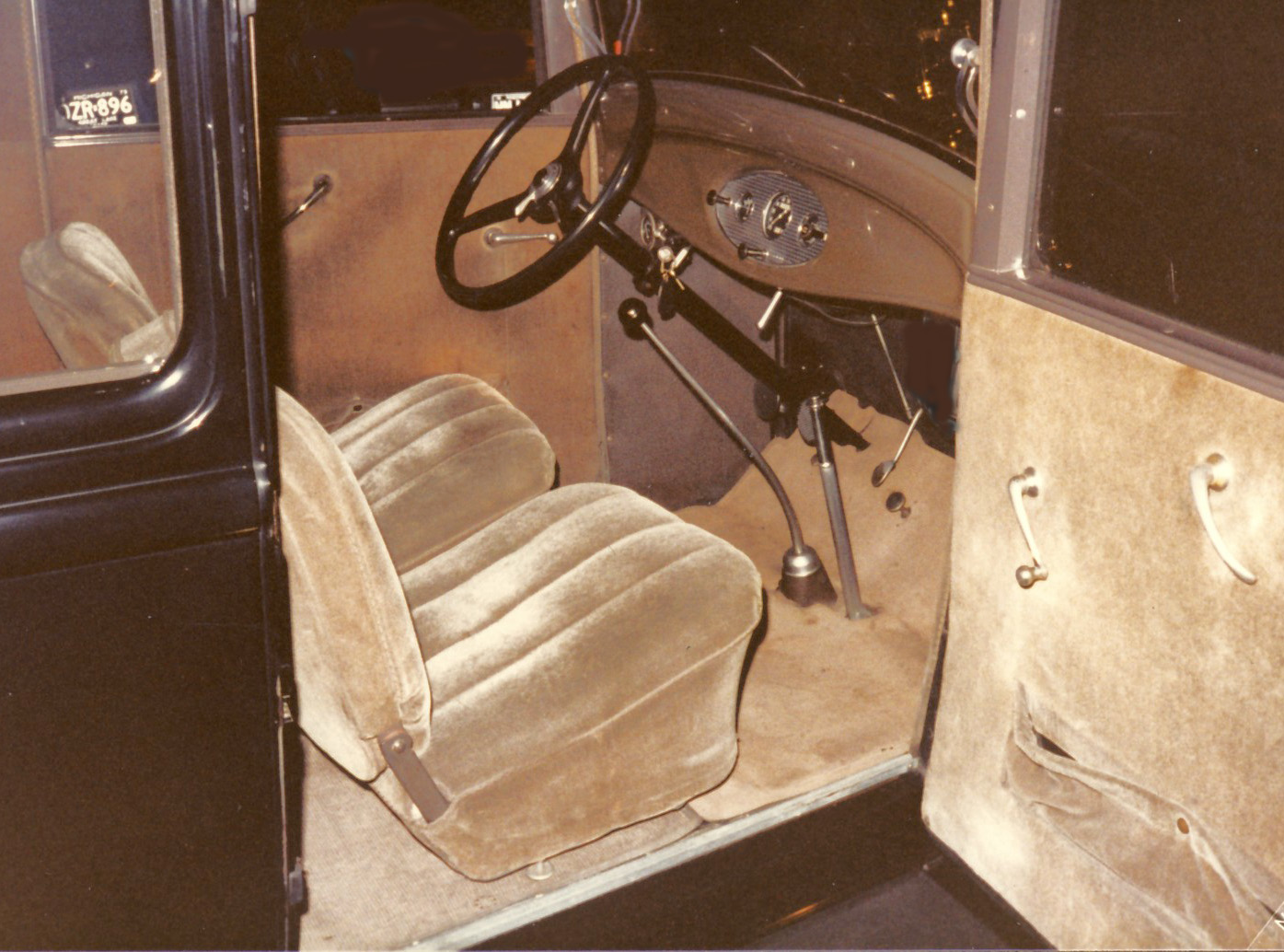

I have a question about the dash board and that is what color should it be? the interior on the car is a Taupe color. the exterior is thorn brown with a black stripe if that matters.Thanks

Ford called the color 'interior gray', but it was more brown than gray. The attached photos are of an all original interior and that of a restored dash with a good replication of the original color.
3w2
01-07-2018 @ 8:32 PM
second photo.

Thank you very much-now I have a much easier job of getting a color match. much appreciated
