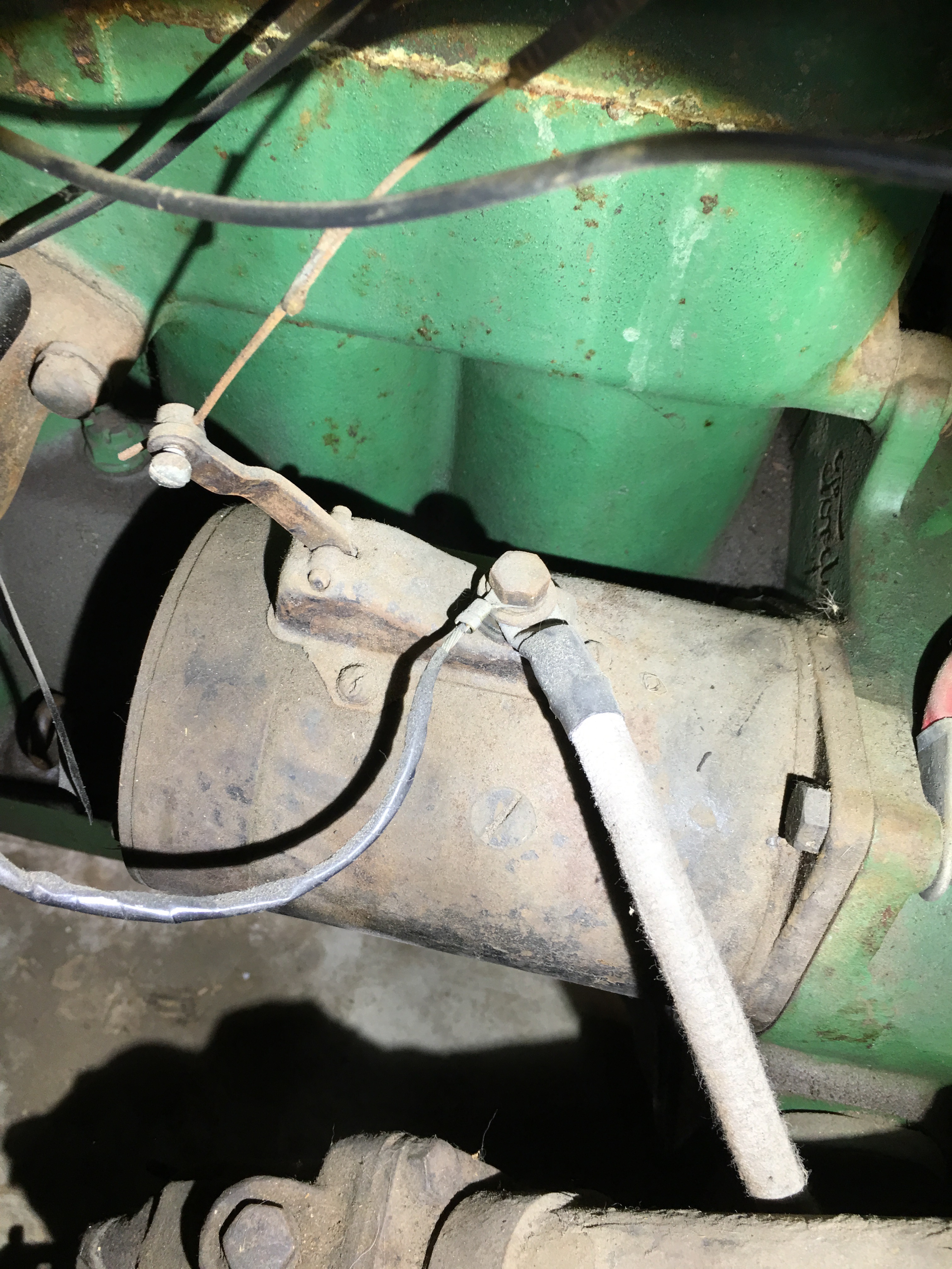

This is the switch that goes on top of the 4 cylinder starter. If it does't match what you have please post a picture of what you have. Post if you need information on the V8 starter switch that was also used on the later 4 cylinder. You should add your general location to your profile. Someone close might invite you over to look at theirs.

Charlie, that is exactly the information that I needed. I have a NOS switch and had figured that it needed a choke style cable to it but the location was the biggest question. Thank you, these forums are great.

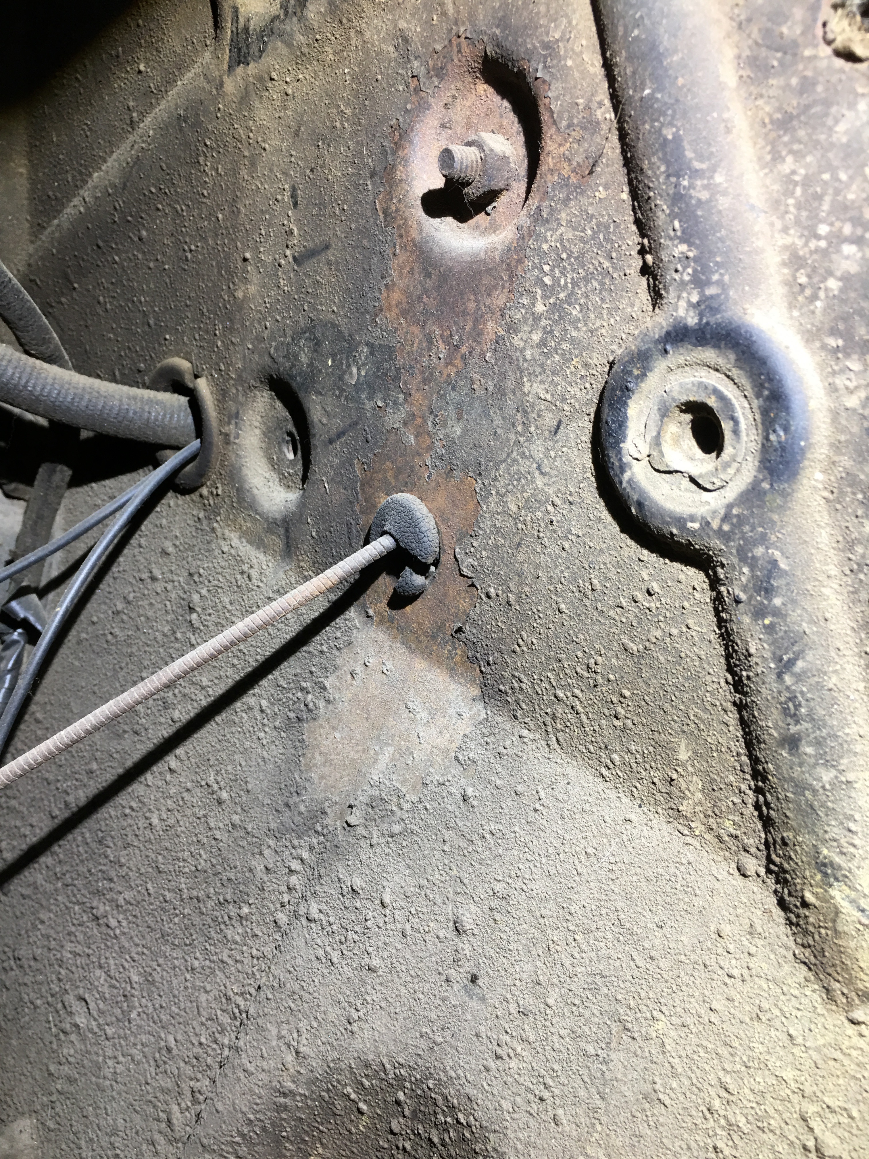

One more photo you might find useful. This is the Model B starter cable passing through the firewall. As an aside, Bob Drake used to sell a complete set of rubber grommets for the '32 firewall.

Charlie, that is also good information. I bought a set of grommets from Mac's but they don't tell you what goes where with the wires etc. I also picked up two choke cables today with the thought of replacing the knob with the knobs that fit the 32 Ford. After trying to work the handle in and out several times, I decided to give it a few shots of PB Blaster to loosen it up. Ended up the cable was so tight in the Bowden wire that I took both of them back to O'Reilly. You couldn't even move them unless you applied about 40# of force. Way too much torque for a starter and choke cable to my way of thinking.

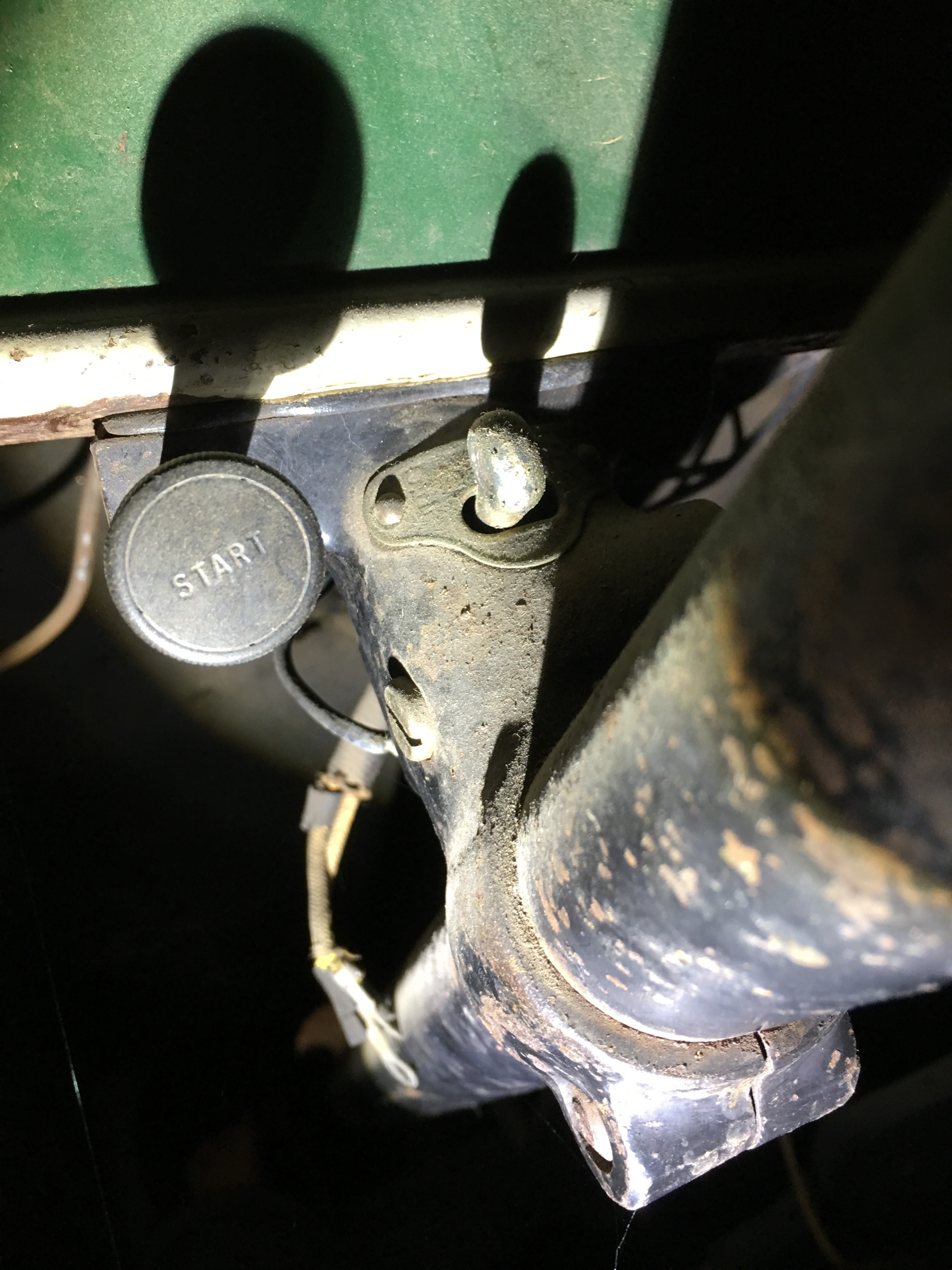

3w2
10-21-2017 @ 7:27 PM
The attached illustration of the knob's location on the steering column bracket may be helpful. The starter control cable is much smaller in diameter than the choke cable
