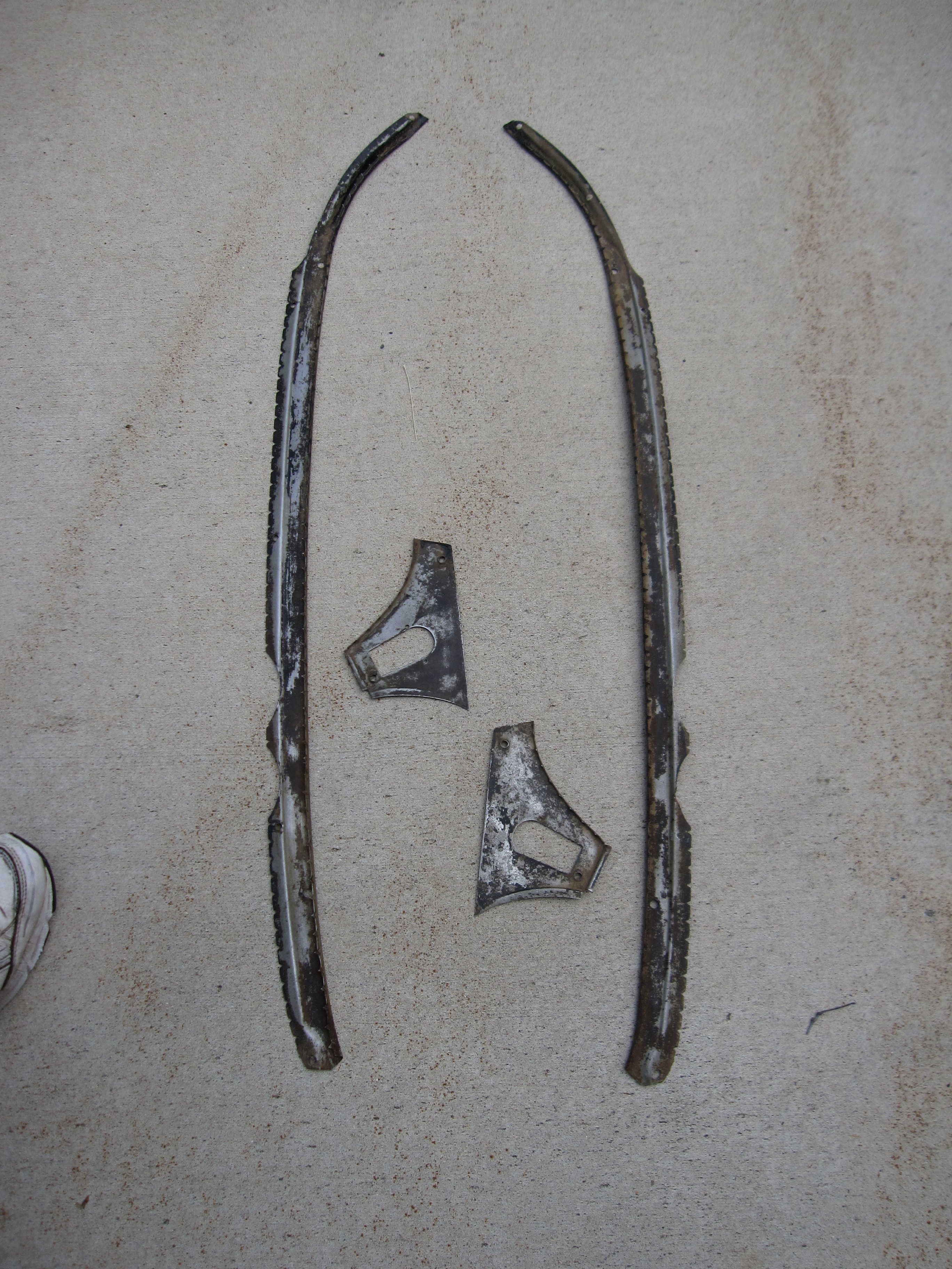

08-04-2016 @ 7:13 PM
Posts: 152
Hi I have attached a set of headliner retainers that mount above the door openings. The retainers are correct for a 1942 - 1948 Ford tudor and 1946 - 1948 Ford sedan coupe
