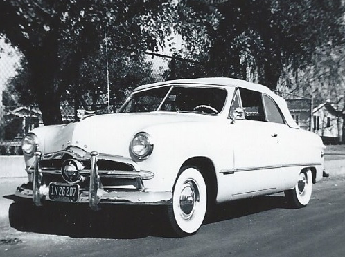

Smooth. They were an accessory on the 15 inch wheels, which were also an accessory. 16 inch wheels were standard and I don't know if you could order trim rings for them. Here's a picture of my mother's new '49:

Answering my own question: Yes, you could order wheel trim rings in 16" (8A-18303-A) or 15" (8A-18303-B) in sets of five. From "The 1949-50-51 Ford Book" published by the club.
