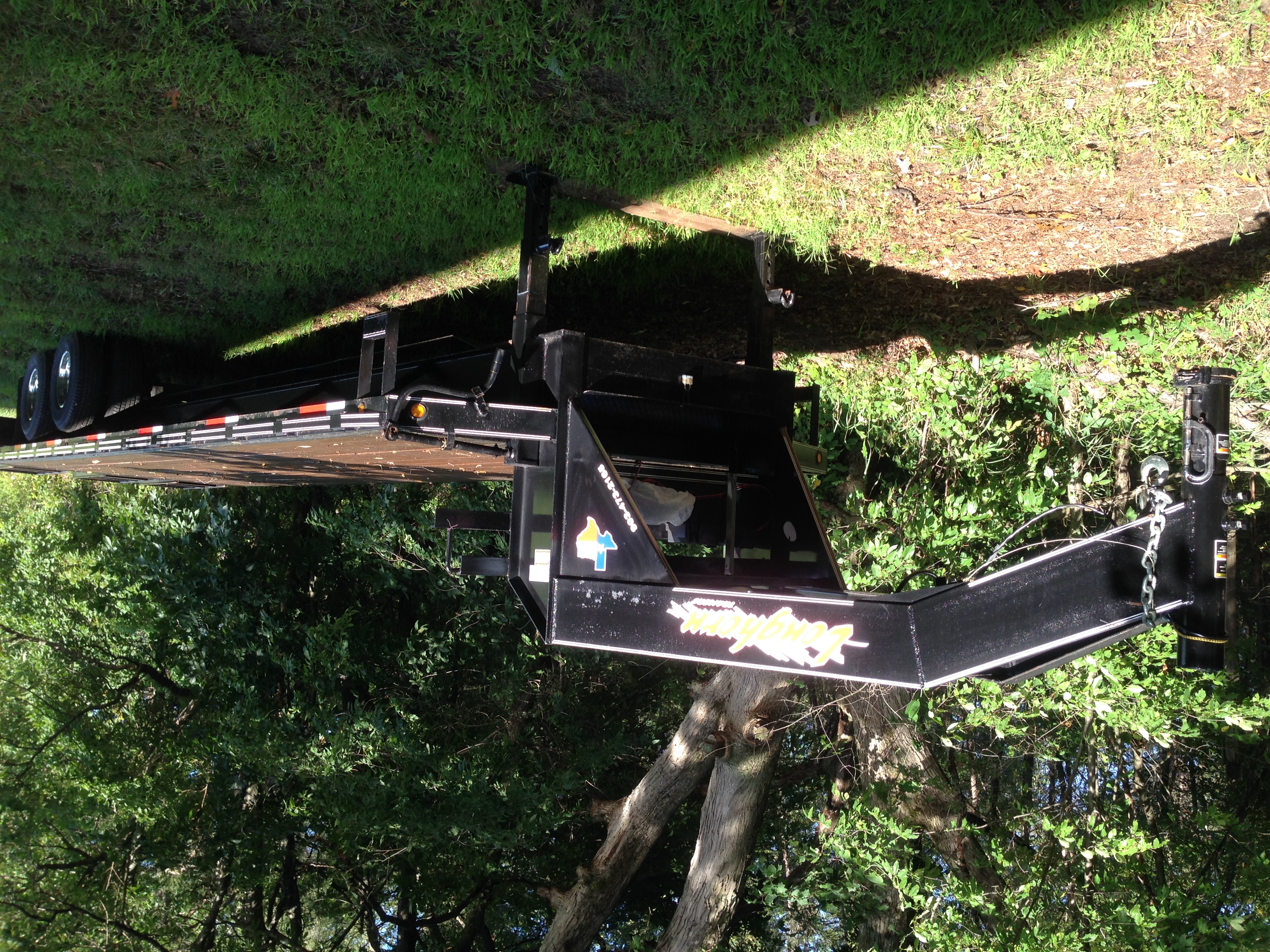

Sorry wrong photo.

Nice looking trailer.
