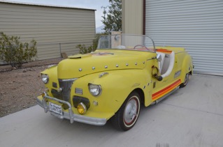

I have a 41 Ford Custom Deluxe, I think, (car at least), and I have a leaking back brake cylinder. Is there a special wheel hub puller I need and where can I get one? I have seen Universal Pullers advertised but I don't know if that's what I need. I sure would appreciate help on this. And while you're at it, where do you find new replacement brake cylinders? I might as well do all while I'm at it.

But then I looked at your picture. That no longer is a 41 Ford as Henry built them by any stretch of the imagination. So I have no idea what you might have for running gear. Better take it to a local generic car repairer and have him tell you what you need.

i'm sorry it took me so long to reply but I thought answers were going to go to my email. Only today did I go back to the forum. Thank you for the reply. And to answer your question, yes, the running gear/frame is still all original. Only the body has been "adjusted".
