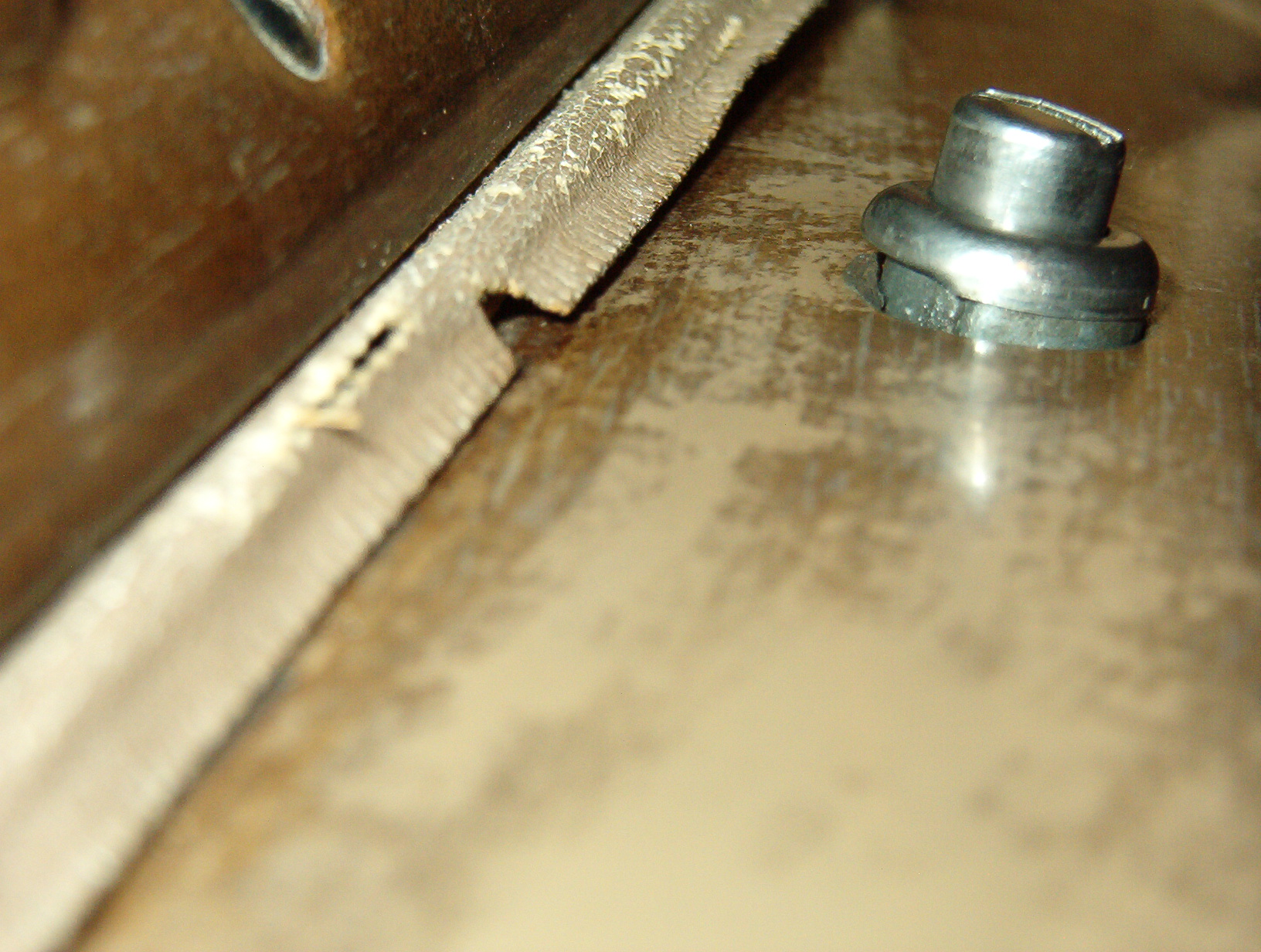

Problem - Unable to remove the glove box lock assembly from the dash. A stainless steel cap is pressed on to the push button and its diameter won't let it drop down through the hole in the dash. How is the cover removed without damaging the dash paint or the cover? Is there a way to maneuver the latch to allow it to be removed?

I was able to get the assembly out. Don't have a clue how. It just decided through a variety of move arounds came out. I'm glad I have it in hand. The replacement locks I see on line don't look like the attaching point are oriented so as to align with the dash flanges and door/striker relationsips. Also the replacements and those said to be original are not the same as ours. Ford must be different mold and installation relationship. Fortunately the lock is malfunctioning such that I can reinstall my original and still open and close but not lock the lid.

Posts: 71
