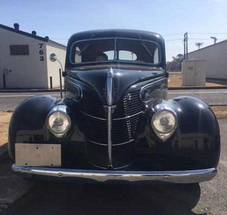

nelsb01----dOES IT HAVE a front bumper and no rear? Give us a pic of the front "not so close"
03-17-2010 @ 5:39 PM
Posts: 1097
the picture was part of the set that I sent to Lawson. He has over 100 photos of this vehicle.
03-17-2010 @ 5:41 PM
Posts: 1097
tudorbill:
Here is your front picture. Yes, front bumper, no rear.
