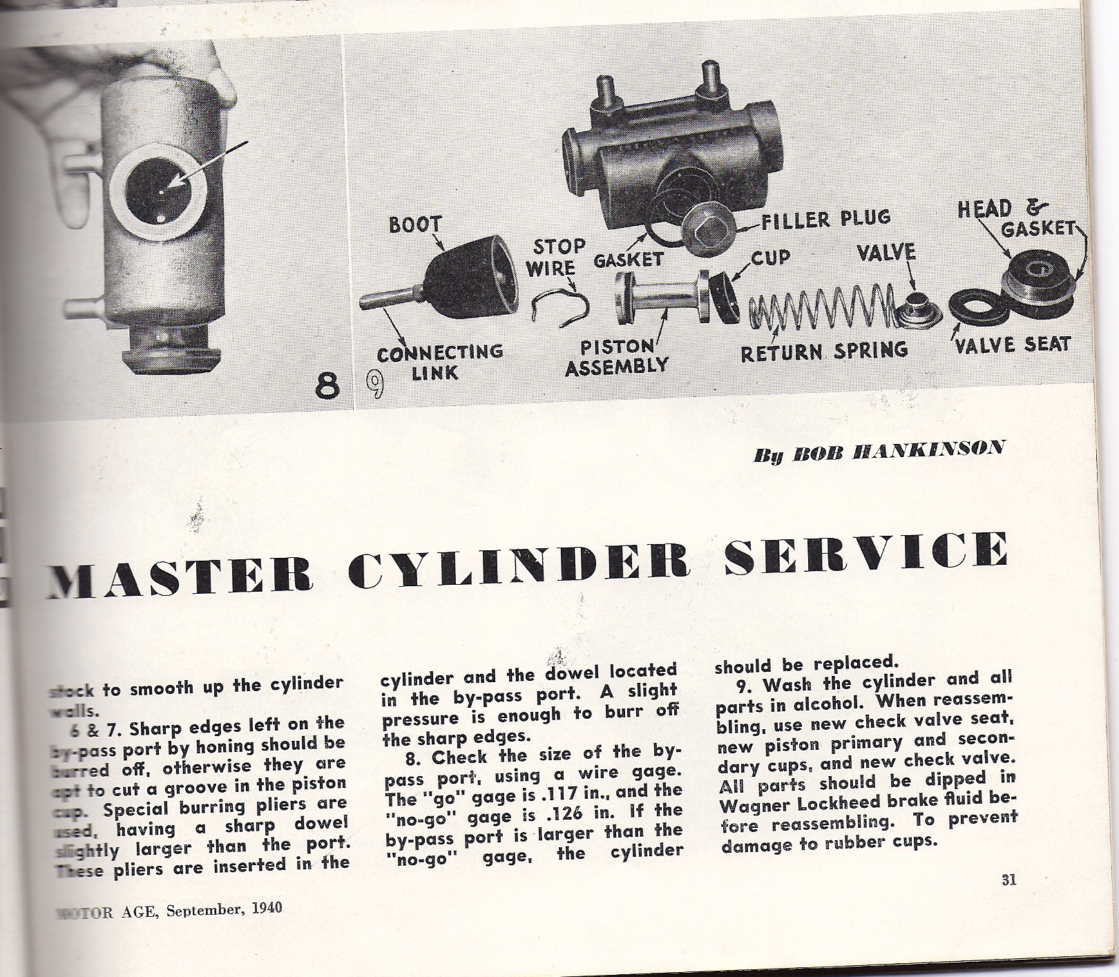

02-10-2016 @ 6:52 AM
Posts: 1801
There is a check valve at the tube end of the master cylinder it allows the fluid to return to the cylinder but maintains a slight pressure after. The valve has to be assembled with it's "rubber" seat. If the cylinder rebuild parts are not assembled properly the slight residual pressure will not be there and this will increase pedal travel. Below you will find the correct assembly sequence, even though this may not be your cylinder.
