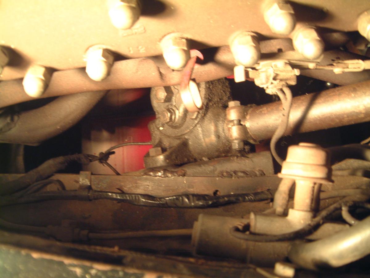

The stock log type '34,35,36 exhaust manifolds are the easiest to use, they hug tight to the block and don't interfere with the steering gears. The left side'36 exhaust manifold has a "dip" to clear the oil dip stick... The earlier manifolds don't have this dip. Hooking the upper radiator hose up can be done with long flex hoses or using short hoses with a metal tube between them. The pix I have attached shows a 59 AB engine in a '36 Ford which is a very similar application to a '34.
Bill 36 5 win delx cpe
