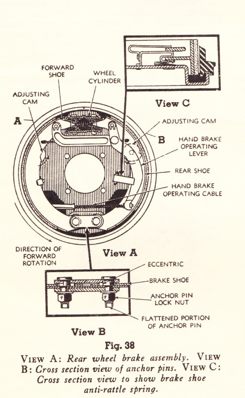

Still trying to get emergency brake hardware installed and adjusted correctly in rear brakes. Do the vertical levers 2104LH and 2103RH install so they slide forward inside a clip that also keeps the rear brake shoe somewhat in place? The clips in question attach to the backing plates but in my case are different side to side. Right side clip has slot for maybe the lever 2103, the left side does not. Any photos would help greatly. Thanks Bob A.
01-20-2015 @ 8:00 AM
Here is a drawing of the rear brake assembly

Tom, you have made my day! Thanks for the picture/drawing. Bob A. Now to find a clip.
