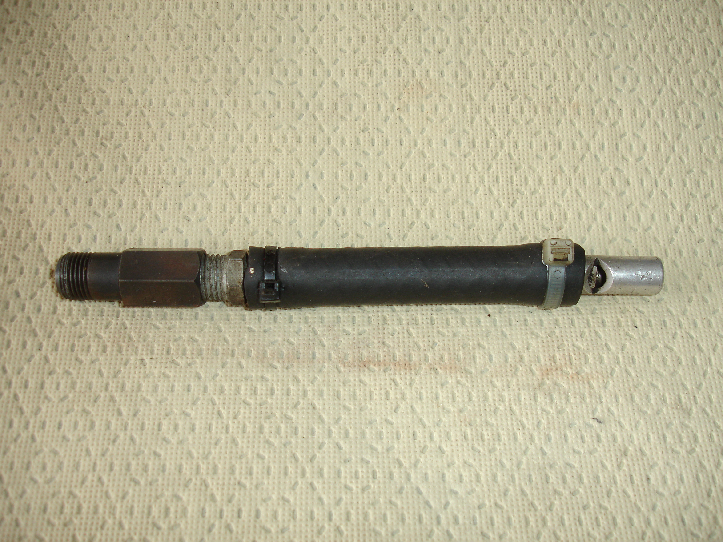

My friend Alan is giving you the right reply. If you want to find TDC on any four cycle engine. Put your finger over the spark plug hole and turn the engine until you feel compression. This puts you on the right stroke. Then turn the engine until the piston is at the top of the stroke. If you can't see the piston, use a piece of stiff wire thru the plug hole to feel when the piston is at the top. Mark that point on the crank pulley, and make a pointer to confirm the mark. As Alan points out, the Ford offset distributor tang makes the timing foolproof. That said, the distributor must be properly set to complete the timing. I have installed a TDC mark to confirm advance with a timing light when something is amiss, such as a skipped timing gear tooth, without having to disassemble the engine. It is also a big help when trying to setup those aftermarket electronic conversions.

I always waited for the toot to stop. Bob
