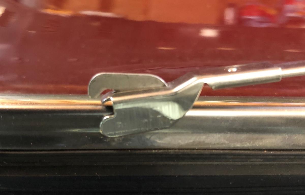

MICHV8
07-04-2014 @ 5:57 AM
Posts: 500
Joined: Jul 2010
Don
Speaking of sedans, does the 36 trico stem have a mounting hole? I rebuilt what I believe to be the original trico, but I do not have any wiper arm that mates to the stem. My camera would not focus close enough, but the attached does show the stem hole...

Don Rogers
07-04-2014 @ 8:23 AM
Posts: 512
MichV8, You would use an early wiper arm and blade as shown in a photo from Bob Drakes Catalogue and from a Ford Parts Book.
Don Rogers
07-04-2014 @ 8:24 AM
Posts: 512
And
Don Rogers
07-04-2014 @ 8:25 AM
Posts: 512
Larry, I would use your wiper motor spacer to reshape the hole in the windshield frame.
