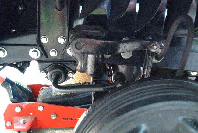

here's a picture of the extended shackle bolt that i used for the lower rear shock mount. i think i got it from pete & jakes too but, regardless, make sure the shackle end is long enough to fit the rear spring because it's is a bit wider than a '36 front spring as i recall.
i forgot to mention that you have to line up the bracket carefully with the lower mount. otherwise the shock will be at an angle and will rub on one side of the bracket.
i've also seen a triangular shackle plate with a third hole for the shock bolt.
