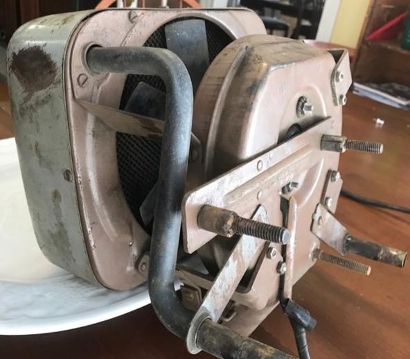

Do you have a heater to install? Do you have a heater switch? See hose routing in the picture. What state are you in now? My 50 came from Tucson, with a heater.
