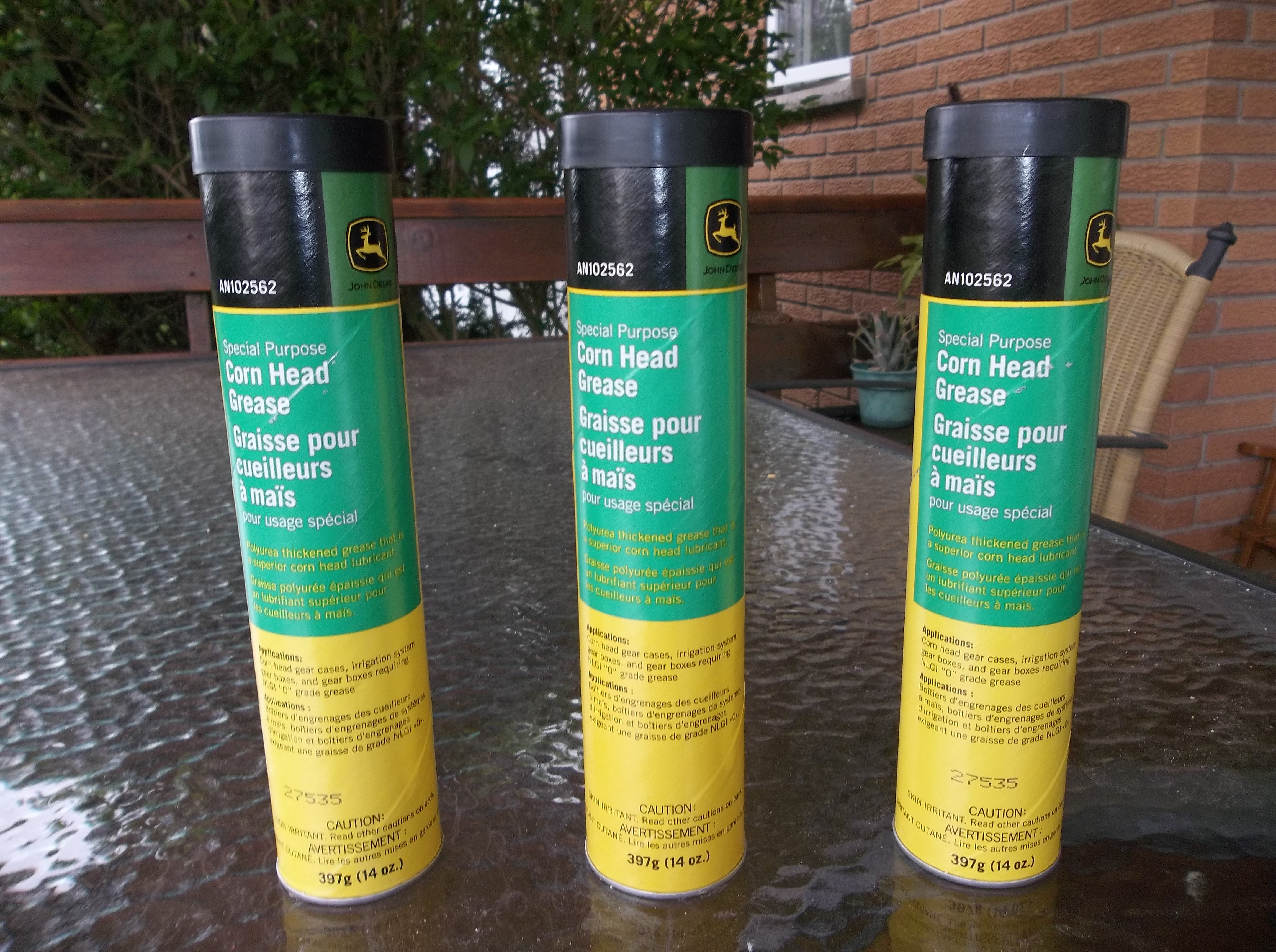

I've tried to show two photos of John Deere corn head grease which was purchased earlier today.
The stock number is AN102562.
The dealership's Parts Department employee says that it is well-suited for steering boxes and gear boxes. At high temperatures it will start to liquefy, but then thickens again later when it cools off.
Amongst other things, the wording on the back of the tube says:
Excellent performance at extremely high and low temperatures
Maintains consistency under severe working conditions
Problem solving grease for gear boxes with leaky seals
NLGI grade No. 0
CAUTION: SKIN IRRITANT
