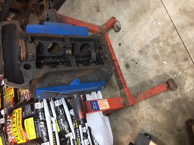

rodrelic
12-16-2020 @ 1:36 PM
Posts: 2
Joined: Mar 2018
Made 1 stand out of 2 cheap junkers, very stable and no fear of damage
