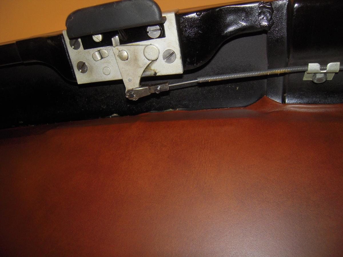

Some pictures attached that hopefully will help. Cable is simply choke cable used on lawn mowers, etc. Most farm supply places sell it by the foot.
Latch is going to be tough to find.
Handle is the same as any 39 Ford but requires a piece that pulls the cable - easily fabricated.

Dear Kube, great photos. Thank you so much. I wonder if the striker plate would be the same as the coupe trunk. That one is available. Thanks again. Phil
04-17-2013 @ 1:07 PM
Posts: 3577
The convertible coupe mechanism is very unique.
