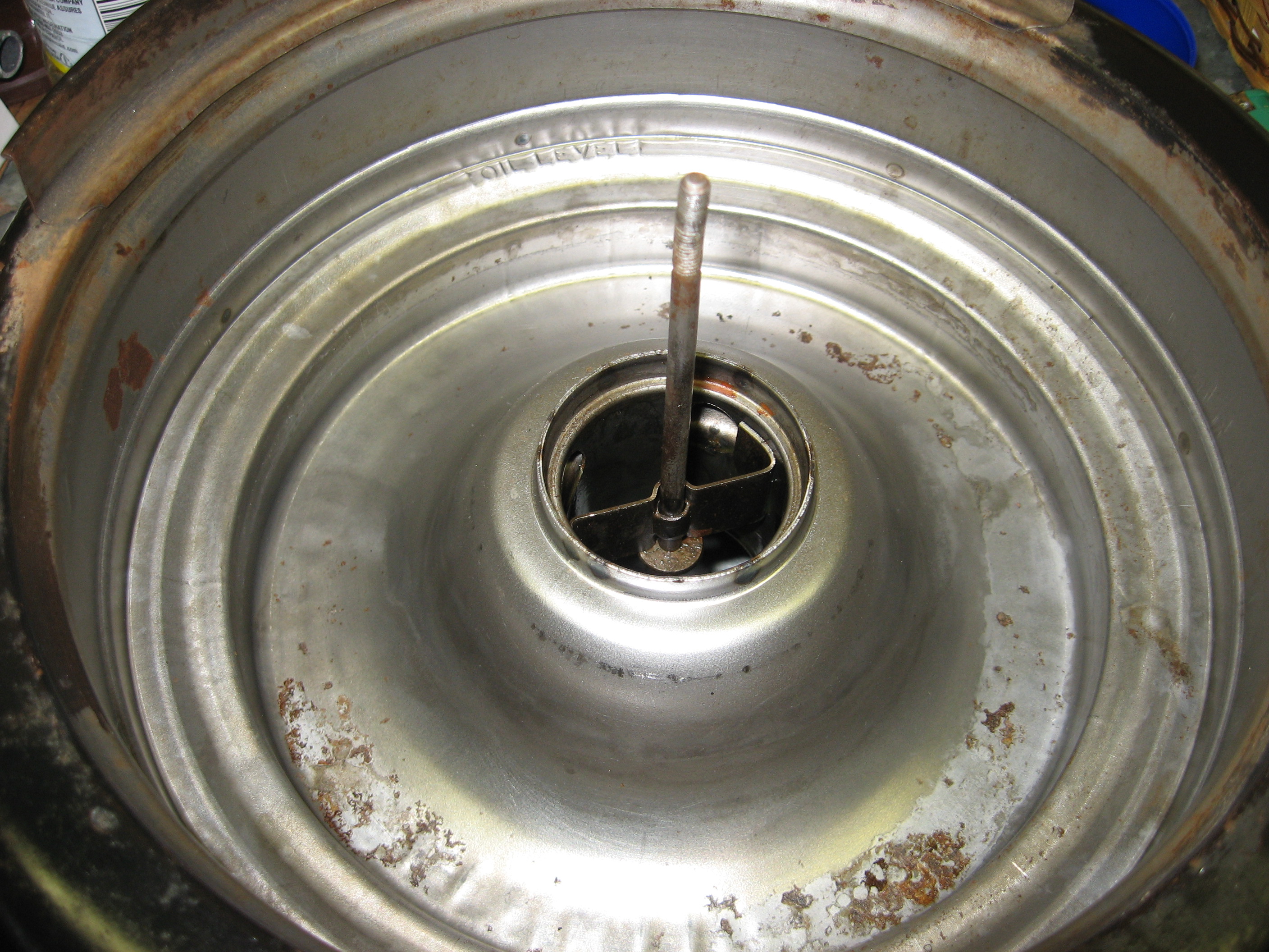

Just in case I don't understand which side of the bumper you call flat and which side you call raised I'll offer this photo of my clutch pedal pad that I would say has the flat surface hitting the underside of the floorboard. Note that this is the bumper that has some of the left side cut away as pictured so as to clear a body part when the pedal is depressed to the floor. The brake pedal pad is a full pad without the cut-away. After this post with the photograph I'll post one with the Green Bible diagram that shows the clutch pad with the cutaway.
(Sorry. I forgot to shrink the photo so it's pretty big but still shows what I'm talking about.)

02-11-2013 @ 4:41 AM
"flat" and "raised" what sides are these???
One side of the seal is smaller than the other, I believe the larger side goes to the wood toe board (see Old Henry photo). The seals can be rotated 180 degrees on the pedal after install so the seal covers the entire hole in the toe board and clears obstructions there is no need to trim them.
