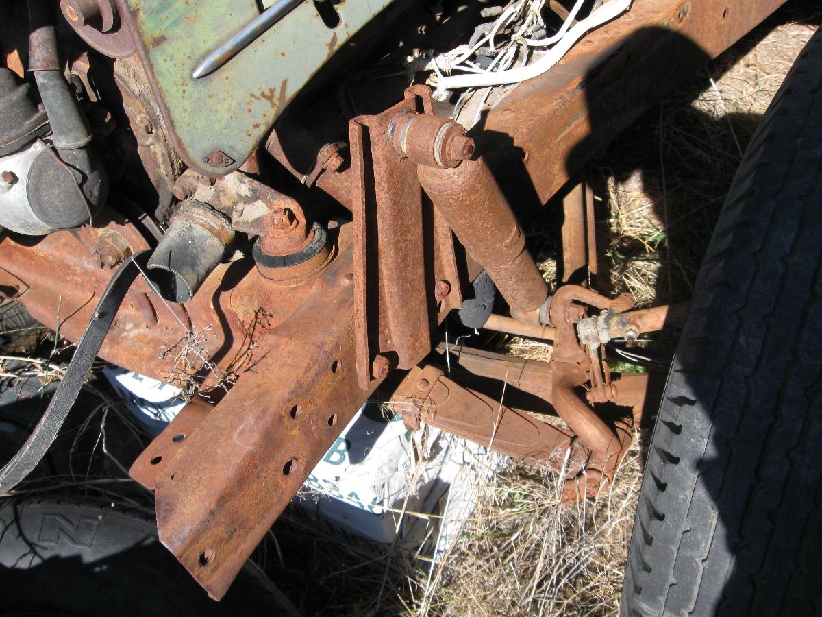

During a resent trip to Idaho I came upon a '36 Ford that had the same front shock conversion as my coupe.
I always thought the conversion was very simple, yet it works very well.

Bill: my 39 looks to have the same set up on the front(picture attached). Its been on since 1960 or earlier. Glad to hear that it works well. so I'll probably go with it. I posted a forum question about my rear shock conversion from 1960 and saw your reply. Isn't that how the 46-48 Ford rear shocks mounted?

The "short mount" front shock conversion for the '35-36 and possibly '37-38, uses a much shorter shock than the later '41-48 FORDS.
The part number for this short shock is Monroe #KB18167. The shock is 11-1/2" center of eye to eye, fully extended.
The shock is 8-7/8" center of eye to eye, fully collapsed.
The shock requires a special lower tapered mounting pin that attaches to the original lever shock mount on the top of the axle.
Super is correct that all of the original EV8's prior to 47 had lever shocks, both front and rear. Many people converted their shocks because they felt the tube type shocks were better.
I always thought the angle mounted rear tube shocks worked better than the lever shocks. The tube shocks tend to reduce body roll and sway.
Parrish's observation about the rear shock setup in the pic I posted is correct, it is a '46-48 Ford/Merc Columbia complete with shocks and sway bar under my '36 Ford.

The shock Randy notes sounds like it might work well for me. The length between the upper mount pictured early in this post and the lower mount (picture attached) is 11 inches. I believe the lower is original from the lever days, so will I need that special lower tapered mounting pin Bill mentioned?
