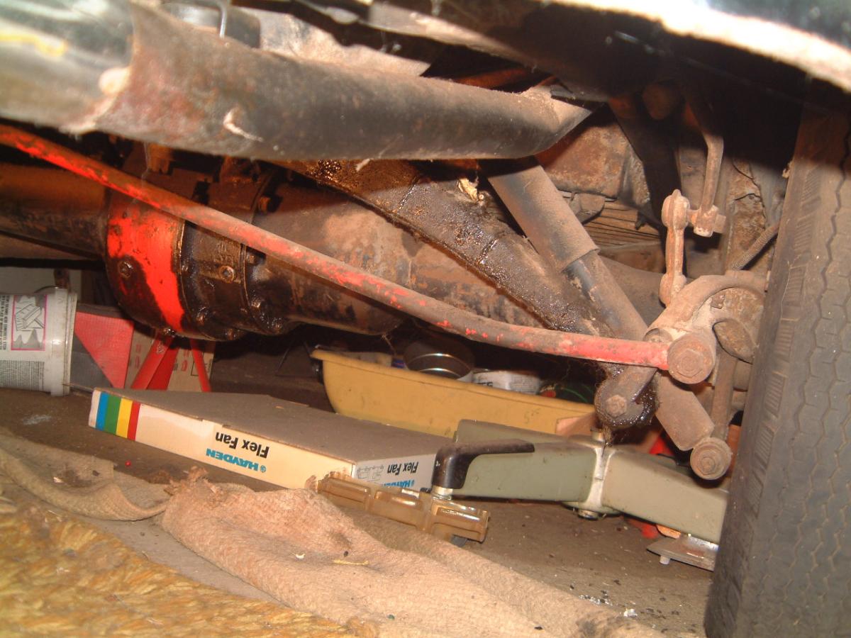

I interpret the pic is showing a type of conversion to replace the stock rear shocks, which would have been mounted to the lower portion of the frame.
The more common modification mounts to the backing plate, then the shocks lay on an angle, mounting to the rear cross member..... See attached pic.
The advantage of having the rear shock mounted on an angle to the chassis, is that the shock tends to act as an anti sway bar also.
Bill

To respond to tudorbill's question about a source for a rear sway bar for his '35 Ford.
I don't know of any vendor that makes a sway bar kit for the front or rear of any stock EFV8's...
The one shown in the pic I posted is a stock '47/48 Ford setup, other than the attachment bracket I made for the rear cross member.
My rear end is a 47/48 Columbia.
With some welding skill and a pile of steel, a person could fabricate up a bracket to attach to the backing plate bolts, then make the bar from from heavy bar material,,, etc.
I have also seen a bracket that attached to the axle tube using U-bolts... The trick is to get the bar to clear everything.
In reviewing the pic I attached, you should note that the bar is slightly V'd to clear the exhaust pipe
Bill

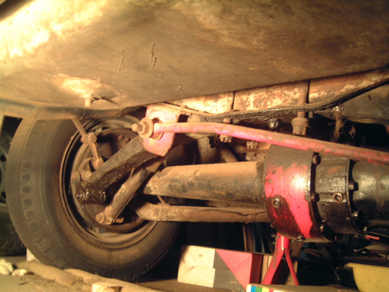

Attached is a pic shower the connection of the stock sway bar to the 47/48 rear axle assembly.
Bill
