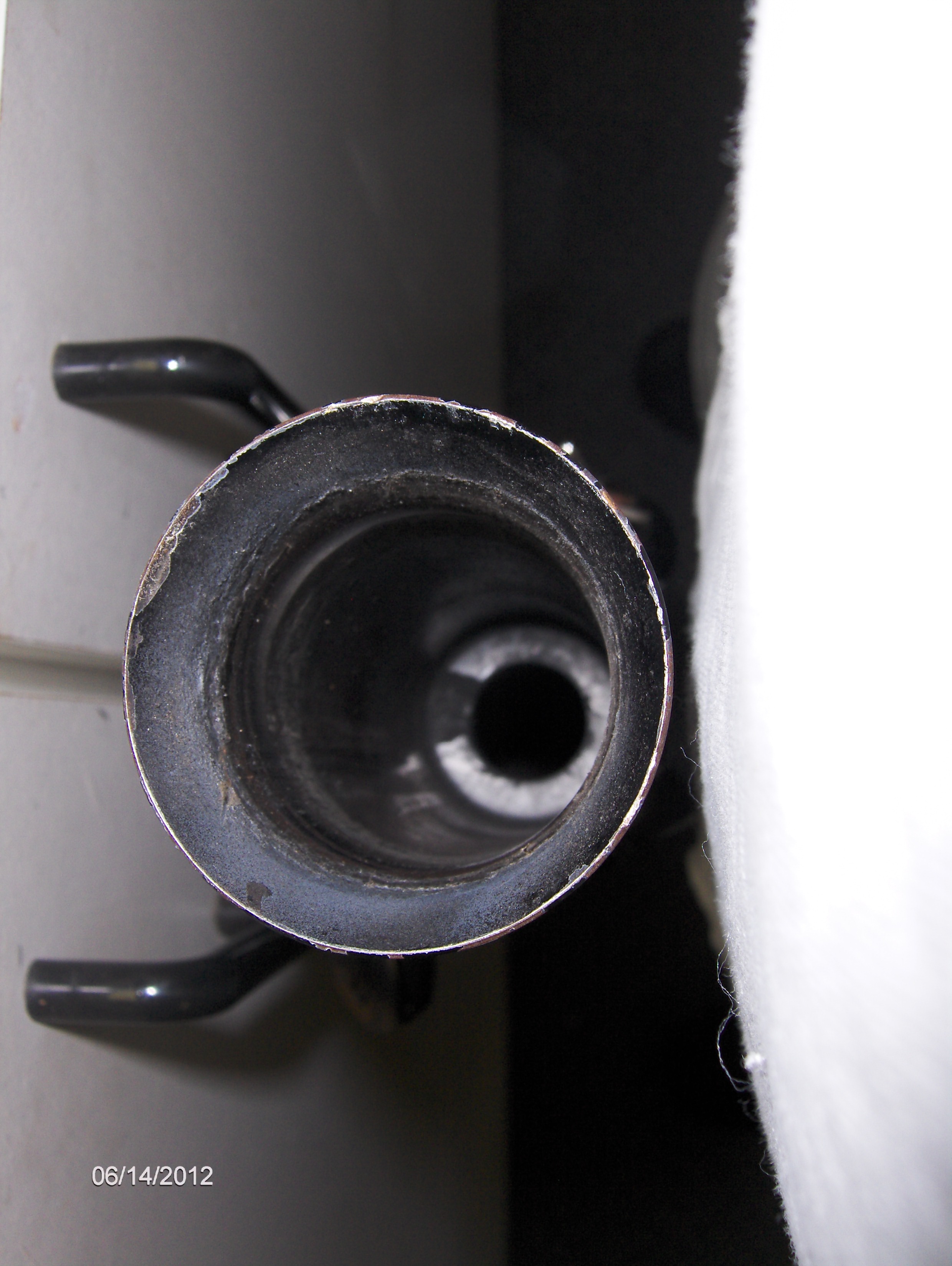

I have an open car and decided to remove the column shaft since I wanted to also remove the lower bushing (PN 3533) which was dried and crumbling in the shaft although Dan said it was not necessary to remove it. I was able to push it out using a long piece of PVC tubing. However, I could find no replacement part for it.

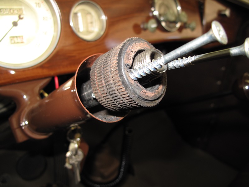

40cpe,
I was able to screw some 4" deck screws into the old bushing and work it out.
Ken

The shaft has no "joint" down at the gearbox, so that is not a viable solution. Some have been able to remove the old bushing by scr*w*ng in long self-drilling deck screws in order to have something to pull on. If you were able to remove the horn/light switch rod, without destroying it, I'd assume you have a convertible or roadster. In this case your solution will allow you to remove the column as well, and then simply drive the bushing out from the bottom with a sawed-off broom handle or wooden closet rod.
