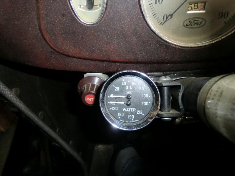

Billc, I had the same problem as you with my '34 Sedan - no factory oil pressure or water temp gauges. I solved this by installing a Smiths Dual Gauge. It's a mechanical gauge made in England and does both jobs in a single gauge housing. I was especially attracted to this gauge given the limited space on the bottom of the dash. I installed it in a standard 2 inch gauge cup and strapped it to my steering column. It connected to the LH water pump and the engine block with no special fittings. See attached photo.

Here's another photo of the Smiths Dual Gauge - at rest. It almosts looks factory correct. I now have peace of mind while driving down the road.....

I think that I could put that in place of the ash tray on my 36. Thanks for the idea. Brian
