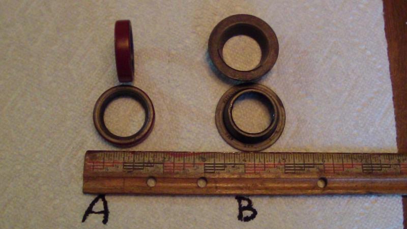

JM
03-31-2017 @ 9:54 AM
Posts: 823
....and the last picture that I have.

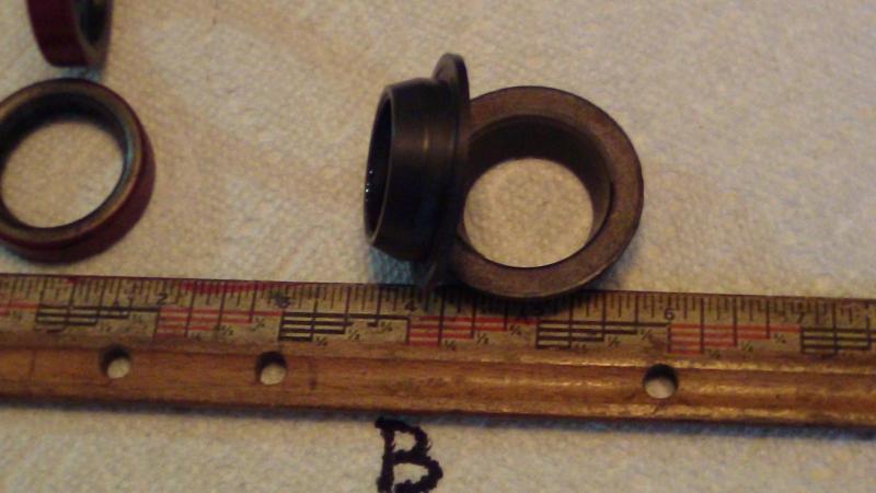

03-31-2017 @ 9:42 AM
Posts: 823
Another picture which shows two different types.
John

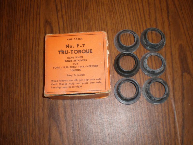

JM
03-31-2017 @ 9:38 AM
Posts: 823
These may be the seals you are looking for. There was a post on fordbarn that gave details and pn's on this and similar type seals
