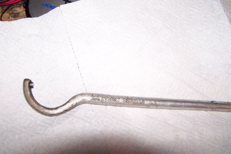

This is the tool (or something like it) to remove the neck. However, even with the correct tool removing the fuel neck on a '35-'36 can be a REAL challenge. Use the best rust-buster you can find (a 50-50 blend of acetone-ATF works great) and let things soak for a few days.
It is not unheard of that in some cases guys have resulted to cutting the neck to remove the tank and then used a fuel tank hose to reconnect things back together.
Good luck.
