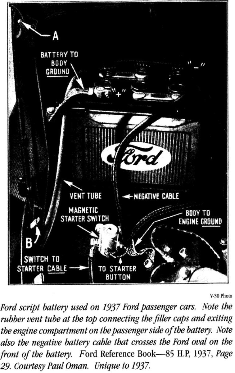

This picture is from "The 1937 Ford Book" published by the Early Ford V-8 Club. I'm sorry that the scan comes across very dark. You can barely see the tube going across the top. In the book, it looks like the battery caps are unscr*w*d and connected to the tube.
If you can get your hands on the book, the picture is much better than this scan.
Ken

I appreciate your input/expertise in this matter. I'm not trying to be "Concourse "original" on the caps and vent tube" although this would be a plus should I ever decide to do so. What I'm trying to accomplish is to avoid what happened and what I described in a previous post (02/15/2011) I made here titled "Battery boiled today". I filled my battery as per the instructions in my '37 Owners Manual - Ouote: "When adding distilled water to the battery, fill to the bottom of the of filler tube in each cell". By my doing this, battery fluid/acid (due to expansion) sprayed over the right side of the engine compartment while driving to and from a 60 mile event. I'm of the opinion that the "vent tube" arrangment as pictured in the manual will prevent this mess from happening in the future. Functionality is more important to me than being "Concourse" correct. What do you think about my fix as described above? Again, what I've built thus far looks exactly as pictured in the manual. Where can I find a "D" shaped hose? Do you have an opinion about my "plug" question above?

MG, Yes, the rubber plug sounds good, if only to prevent fumes in the engine compartment. A fun little project would be to experiment in the making of a D shaped tube, but again, neatness is more important here.
Lincoln, I don't know why it never occurred to me to look in the '37 book! We can always count on you to trump all speculation with your research.

The vent tube pictured in the owners manual certainly is not "D" shaped but rather, it is round. I'm using 3/4" O.D. - 3/8" I.D. rubber hose. This hose fits perfectly in the exit hole provided for it in the inner right fender. As for the battery caps, I purchased three 'Raindrip' inline irrigation dripper/nipples at my local hardware store. I drilled the vent holes in the caps to accommodate these dripper/nipples and super glued them to the tops of the caps - looks like the caps were manufactured that way. I drilled 3 small holes at the correct distancing between caps in the rubber hose and slipped/pushed the hose on to the nipples. It's a nice tight fit and the caps still turn. Installed on the battery, I must say, this setup looks exactly to what is pictured in the owners manual. Also, I think it is functional in venting the battery. But again, I can't determine from the picture in the manual if the hose is plugged at the battery end. It would seem to me that left unplugged, air would be forced through the hose by the engine fan and forward movement of the car thus forcing any liquid in the hose out the other end. I do have a rubber plug for the hose and the setup looks much better with this plug installed. To plug or not to plug - that is the question.
