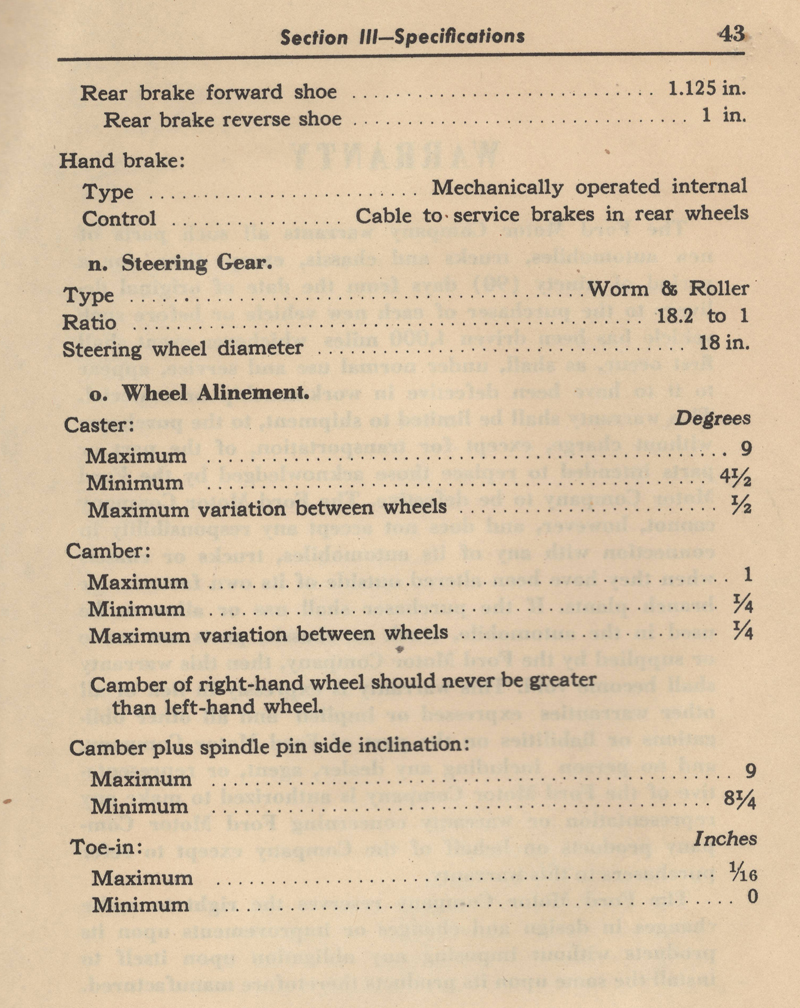

Old Henry
02-01-2011 @ 12:30 PM
Posts: 738
Joined: Apr 2010
Here is the page of the owners manual showing all alignment specs.

I agree with Ken. We have found that 0 toe-in works best with radials. Before you mount the radials, be sure to check the runout (wobble) of each rim with a dial gauge. Any found can set up shimmy with radials because they have less sidewall rigidity than the bias ply tires. Combined with worn kingpins or other loose steering components, an unsafe condition can result.
