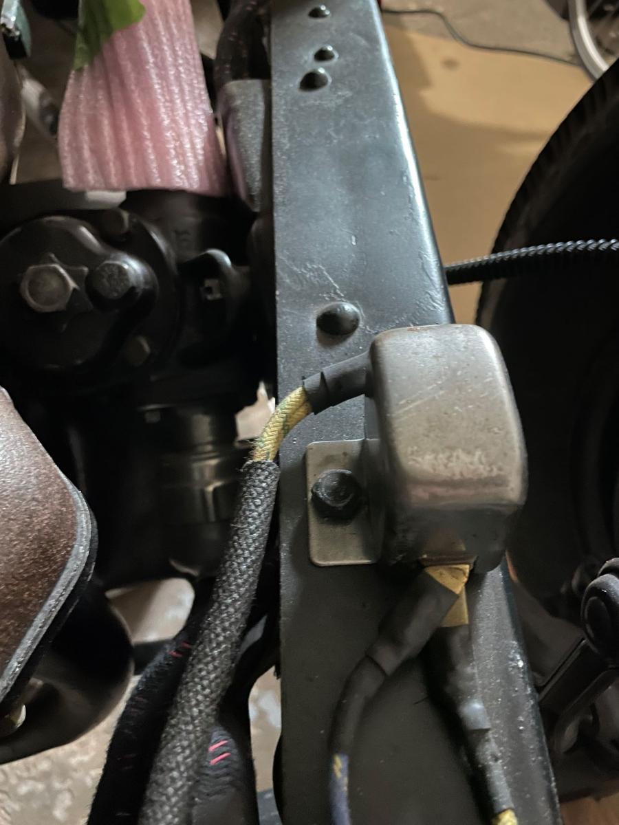

I still think that you either have a defective relay or the contacts cannot deliver enough current to make your horns work.
I have attached a photo of the correct style relay for your car.
The short hook is for the wiring harness and the long leg is for mounting the relay to the frame. If you cannot find one locally, send me a private message and I will sell you the one pictured.
