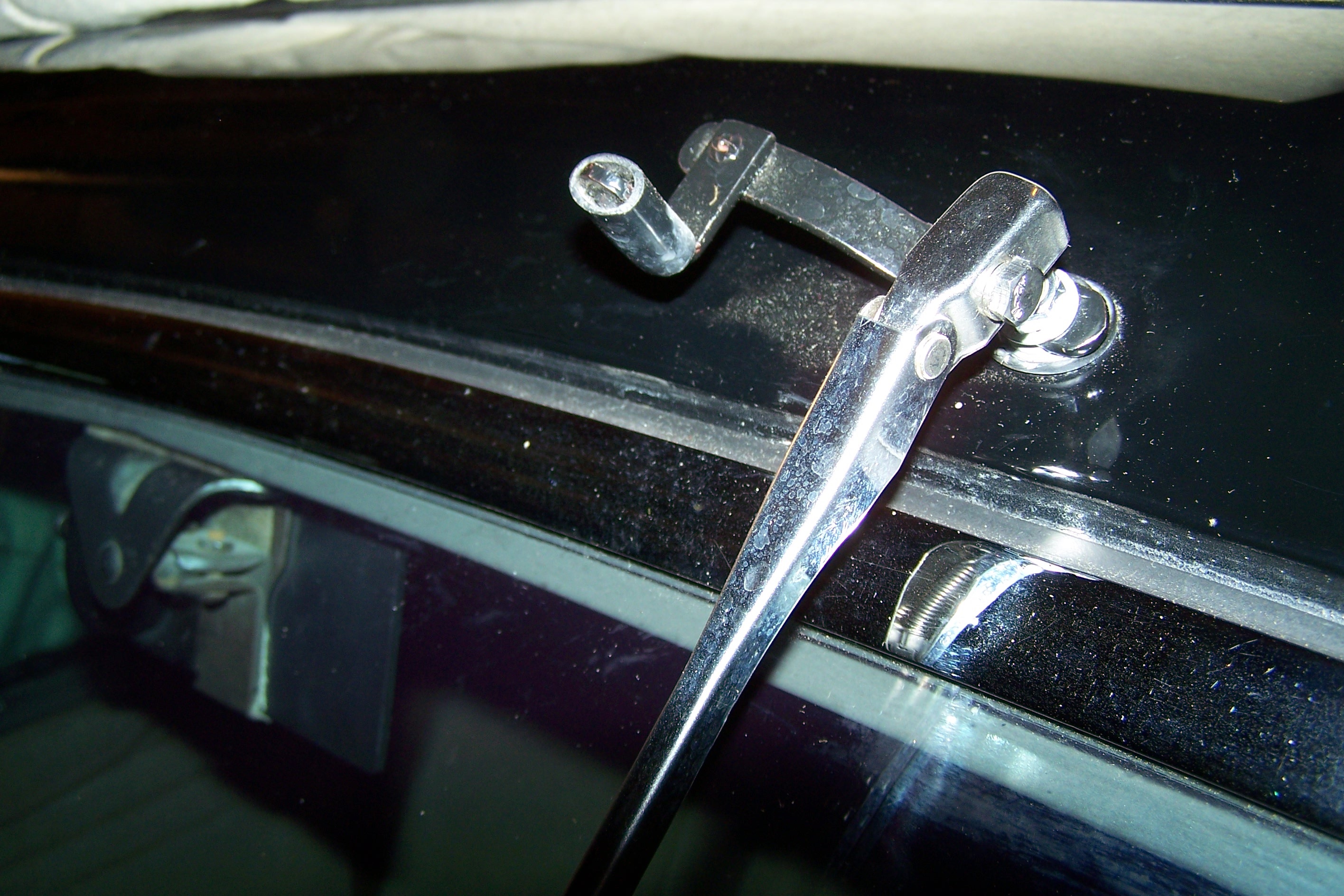

It sounds to me that your motor is ok,but the spring tension on the arm is weak.I had the same problem with my 36, the arm was so weak it couldn't even hold a paper flyer at a car show, I just replaced the arm which solved the problem. I also use a window cleaner called rain-x and the few times I have been caught in a down pour I didn't even need the wiper,the rain would just bead up and blow away.

I was also had a problem with the "fly-away" wiper arm especially with speeds over 45 mph. But, no more. I made a simple stop and bolted it on to the wiper motor shaft. I haven't lost a wiper blade or arm in years!
