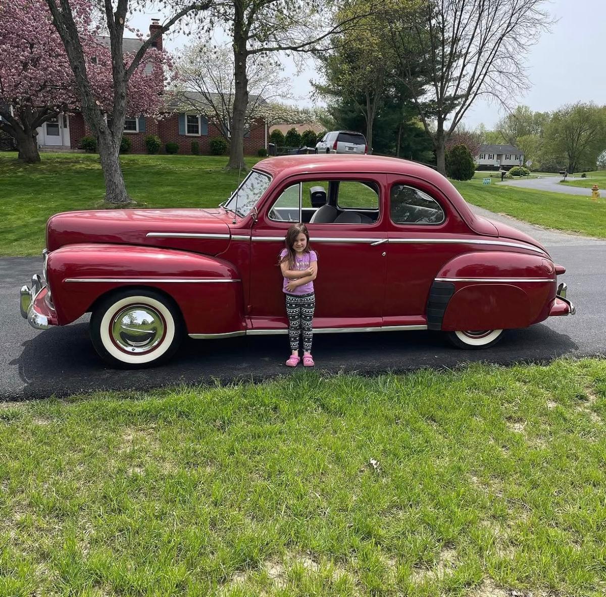

Hello everyone, new to this group. I was given my grandfathers 1948 ford super deluxe. It has a 239 FH with a Holley 94 carb. The carb needs to be replaced but I can not find any vendors that have new carbs for purchase. Can anyone help me out here?

09-01-2026 @ 6:17 PM
Posts: 7488
You have a great looking car and girl friend. If it were my car, I would send the carb to Charley for a rebuild. His rebuilds are mostly plug and play, install it and start driving.

Ditto on the NICE LOOKING CAR !! Send the carb to Charlie as others have said. You will be glad you did.
Then drive the wheels off of that really cool Ford.
