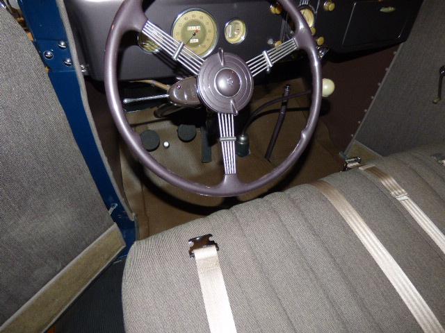

Hi ya Rick.
Here's a photo of an "early" '36 three-window. The exposure isn't the best, but should give you an idea...

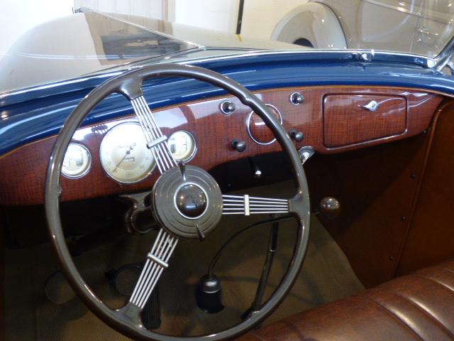

Posts: 3659
And here's a photo of a "late" '36 roadster....

Thanks Mike, the late dash sure is pretty.
