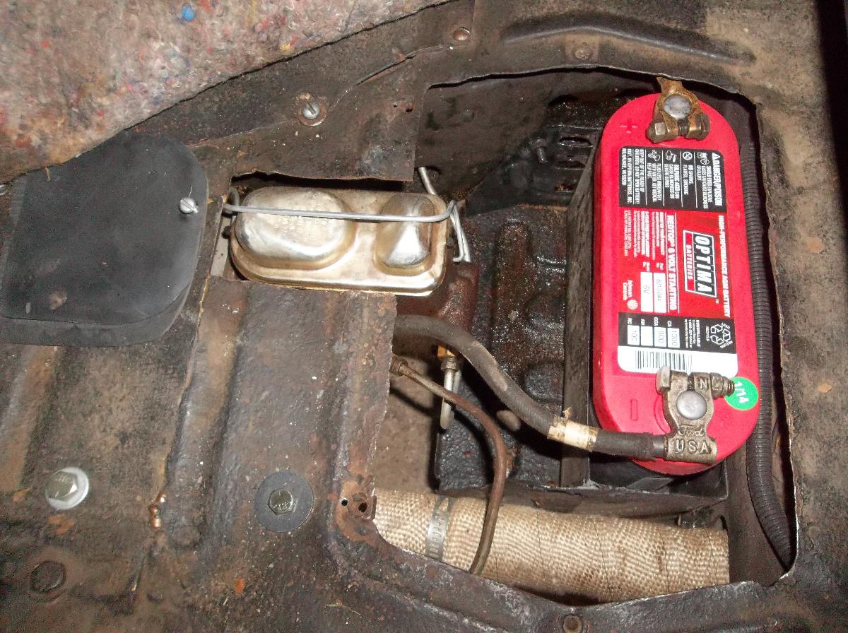

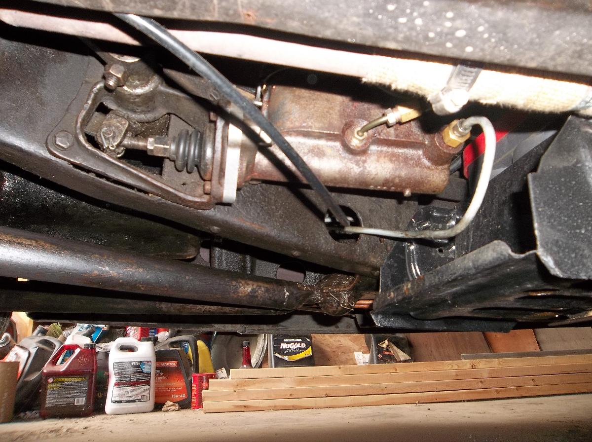

Our definitely-not-bone-stock '36 Ford has a 6 volt Optima battery mounted in a 1949 8BA battery box under the floor (also hydraulic brakes).
Here are two photos.
A vertical steel plate added inside the battery box prevents the Optima from tipping forward.
Works very well. Definitely a high-quality battery.
